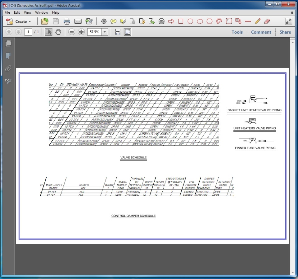

I've got the weirdest thing going on with DraftSights export to PDF function.  Draftsight now skews imported objects.  It is doing this with all forign imports from jpg's to .xlsx (using autocad clipboard insert).  The previous version didn't do this to my understanding.  Draftsight prints these files in 11x17 with no problems, but I need to make a PDF of these so I can make a CD.  I have uploaded a screenshot so you can see what I am talking about.
I am using Windows 7 64bit, DraftSight V1R1.3, and Adobe Acrobat 10.

I'm glad that I saved the version 1.2 onto my thumbdrive.  I ran DraftSight off of my thumbdrive and all my sheets got fixed except for my cover .jpg, which got fixed after trying to pdf export/save/close a few times.  At least I can get my work done.  I'm going to keep a copy of all the versions so that I can get all of the functionality I need.
