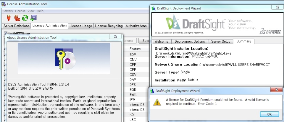

I internally try to test the Deployment Tool. But I got a license error from the Server Setup Tab in DraftSight Deployment Wizard.
It said " A license for DraftSight Premium could not be found. A valid license is required to continue. Error Code: 1".
Now I am using DSLS which is R2014x 6.216.4(the latest version). And I have 'DFS(DraftSight Premium)', 'DAP(DraftSight Premium APIs)' license.
For Server Setup tab, I set type - 'Single', Server Name - 'my laptop hostname', Port Number - '4085'.
DraftSight in my laptop is working great. But for DraftSight Deployment Wizard, it is not working.
I got the Deployment Tool from 'PremiumSupport@DI 'Premium Customer DraftSight Deployment Package.zip'.
In this zip file, I can find 'draftsightdeploywizard_SNL_V1R31.zip'. I think this is for SNL.
Is there Deployment Tool for DSLS?
Could you let me know how to solve this problem?
