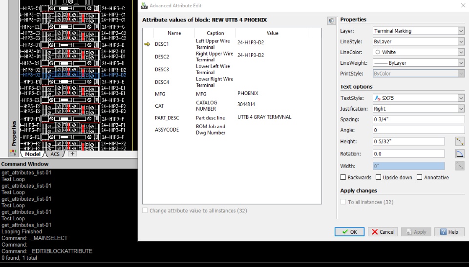

Hello,
I'm trying to pull a list of attributes from a block by using Lisp programming. I can find the blocks by using Lisp, but I can't find a way from the block to the attributes. Everything I've read online shows that this should be the solution, but it isn't working for me. What needs to be done to pull the attributes from within a block? Is this even possible for Lisp to do this in DraftSight?

Lisp program not recognizing the existence of attributes within a block.
