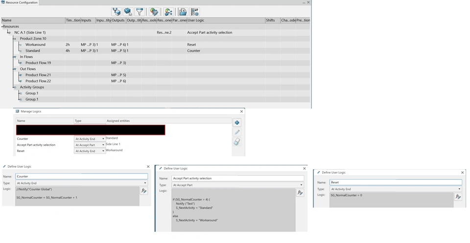

I was trying to figure out how to achieve this functionality:
For two transform activities, I have the same Input (called it, Input). One activity, I have the output, output.2, and the other I have output.2. As follows:
Transform 1: Input 1, Output 1
Transform 2: Input 1, Output 2
I have different activities occuring on this work center but they have the same input and output, so the entire work cell looks like:
EG:
Transform 3 Input 2, Output 3
Transform 4: Input 3, Output 4
Transform 5: Input 4, Output 5
I would like to simulate the behaviour that every 5 times Transform 1 occurs, when the machine receieves Input 1, it instead performs Transform 2.
I cannot do group-based sequence activity mode as my flow is too complex to have a defined sequence.
I tried the following User Logic described in the image.
It appears that the user logic "At Accept Part" doesn't allow me to change the S_NextActivity even though the condition becomes true.
