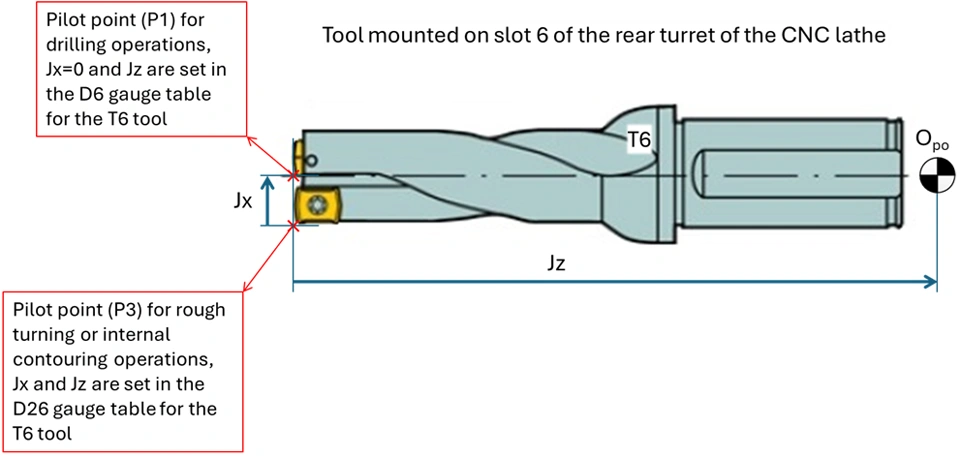

Is it possible to create a single tool that can be used for both axial operations (P1 pilot point) and internal turning operations (P3 pilot point)?
0
