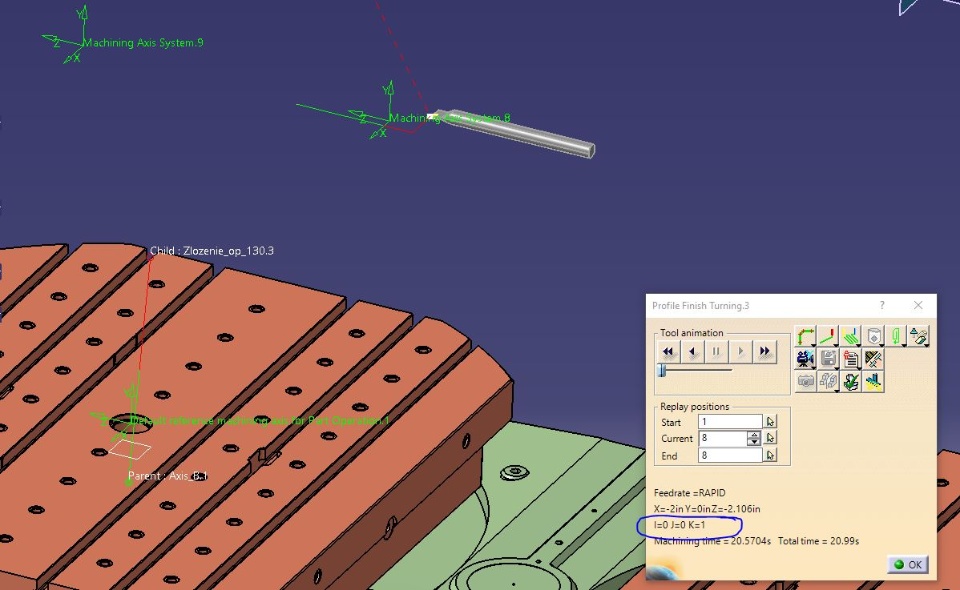

I'm just creating post processor for customer in CATIA V5.
It is 5axis machine with lathe mode

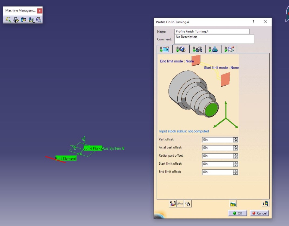

I created additional origin axis in process for lathe
Axis tool of the lathe is to opposite to local axis but CATIA V5 generates vector of tool 0,0,1; it should be 0,0,-1.
Why CATIA V5 doesn't take account direction of origin axis in tool path?
