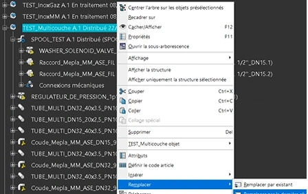

Here is the process we are doing :
1 - we Release the spool
2- we create new revision
3- we replace by new revision

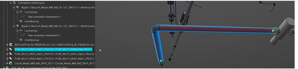

4- then we have message about links and pipe is KO
