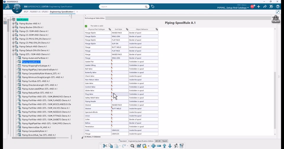

the automatic generation is based on a Spool rule table that must be defined in each piping Specification (it can be the same rule teble for all) and in which you describe the spliting conditions.
  • Inside the spool
  • border of spool
  • outside the spool

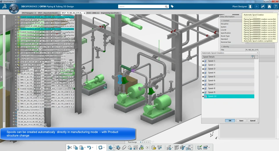

these conditions can be set per couple Part subtype/endstyle
Create Spool in Batch mode
You can run the automatic spool generation in bach, to do that you must first have the Spool rule table well define into your piping Specifications.
Me Preference settings

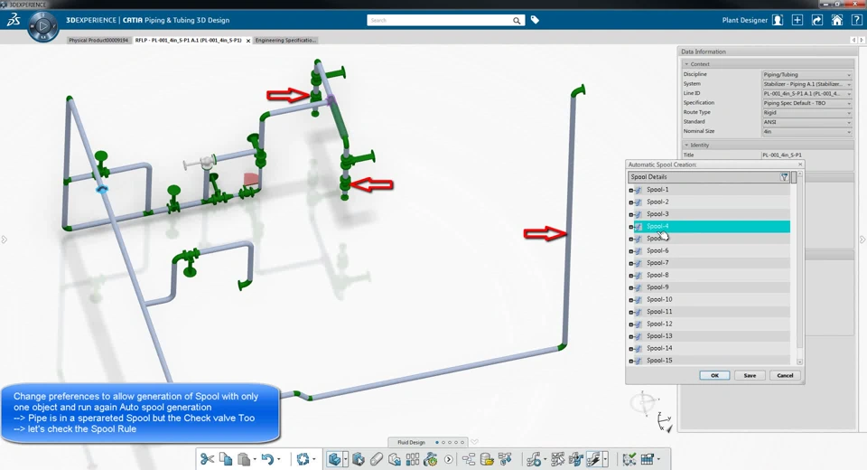

A setting allows you to decide if system generate a Spool if it contains only one member
Spool Rule Setup
Following video explains hox the Spool rule table is working to be able to generate automaticaly the Spools

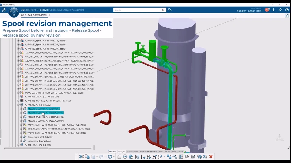

Spool Revision
When doing spool revision, you need to follow a stict process with dedicated commande to ensure link consistency. It consist on moving the contextual engineering connexion outside the spool assembly to be able to be rerouted when the spool is replaced by it new revision
the following video describe the process and command to be used

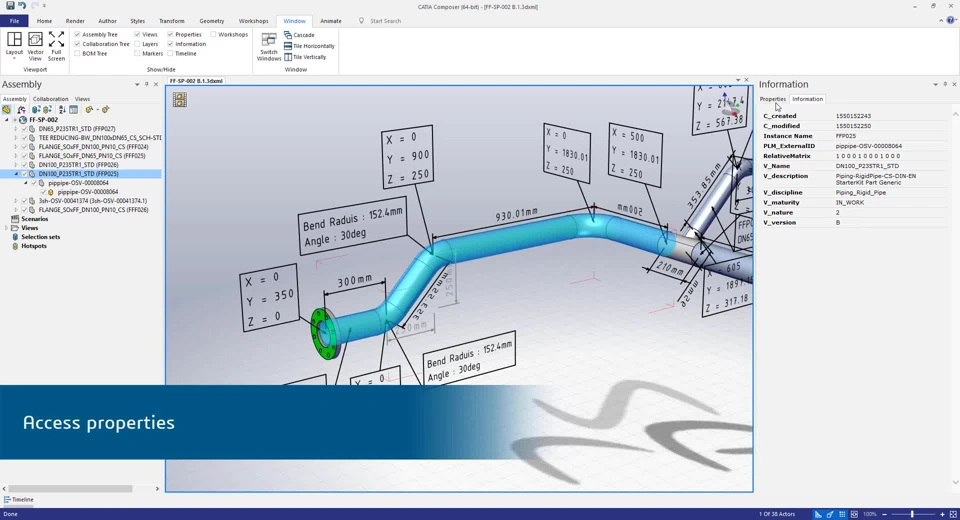

3D Master approach
It is possible to use "3D Tolerancing & Annotation" to add annotation and dimensions directly into the 3D spool for fabrication if we want to not use drawings.
the Annotation can be generate manualy or it can be automated using EKL Action.
Following video shows the generation of  annotation using EKL
following video shows, how to review the annotated 3D spool inside CATIA Composer for people at shop floor.
It is also possible to review it directly into 3DMarkup widjet
