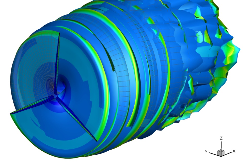

VAST-Simpack simulation of a wind turbine using a free vortex-wake inflow model. © DLR, CC BY-NC-ND 3.0

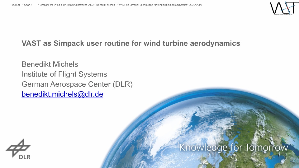

I am pleased to invite you to my presentation that I held at the 5th Wind & Drivetrain Conference on April 6, 2022.

The presentation gives an overview of the emerging wind turbine simulation capabilities at the Institute of Flight Systems of the German Aerospace Center (DLR), using Simpack in combination with the in-house aeromechanics code VAST (versatile aeromechanics simulation tool).
Current activities focus on verification and validation, using a model of the 2.3 MW NM80 turbine from the DAN-AERO experiment.
The Simpack model of the turbine is set up by the DLR Institute of Aeroelasticity, using a python-written converter for the transfer of HAWC2-format input data into Simpack models.
The already available VAST extensions for wind turbine simulations include a BEMT and a free vortex-wake inflow model, both in combination with lookup table airfoils. Furthermore, a geometry model allows for freely configurable blade shapes. Other wind turbine-specific models cover the tower dam effect and wind fields. The coupling of VAST to Simpack via user-routine had already been developed in a previous joint project between DLR-FT and Dassault Systèmes (VaMeSH).
Initial simulations comparing the results with AeroDyn reference calculations have been carried out, showing very good agreement.
See below for the presentation slides.
