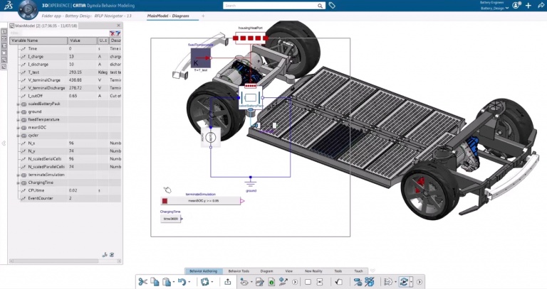

Figure 4: Battery Pack Workflow
In figure 4, we see the implementation of Battery Pack workflows using the 3DEXPERIENCE platform. In this example, we simulate the battery range scenario as well as a battery-charging scenario. The platform enables users to switch between the two scenarios as well as between the 1D and 3D models.

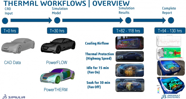

Figure 6: Thermal Workflows
Figure 6, shows validated Thermal workflows that simulate standard testing procedures automotive OEMs use for product development. With automated tools, the total time from CAD to complete a report requires less than six days for all workflows and thus provides significant savings to the vehicle design process in both turnaround time and cost.
Cooling Airflow simulations enable the design engineer to optimize the cooling system layout and evaluate trade-offs with vehicle drag and interior noise. The Thermal Protection workflow identifies components that exceed design temperatures, fixes thermal issues, and optimizes shielding. The Idle and Soak workflow simulates the vehicle testing under transient conditions such as key-off/soak and accurately identifies temperature spikes.

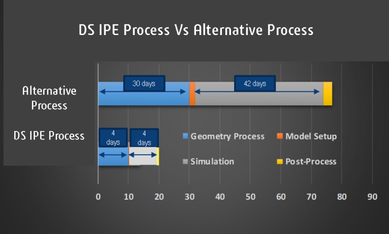

Figure 7: Key Differentiators
In figure 7, we compare the turnaround times for the Dassault Systèmes process and an alternative competitor process. We observe that the turnaround time for both the geometry and simulation process is significantly faster with the Dassault Systèmes process. The key enabler is using the exact vehicle geometry with no simplifications since the PowerFLOW solver has the robustness to handle complex geometries.  For an alternative process, an approximate geometry is necessary, otherwise, the simulation runs the risk of solution divergence. For the simulation turnaround time, PowerFLOW runs significantly faster for transient simulations than the alternative process.

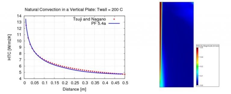

Figure 8:  Vertical Plate Validation Case
In figure 8, on the left, we compare the heat transfer coefficient on a vertical plane as a function of vertical distance with experimental data from [2] and observe good agreement between simulation and experiments. On the right, we observe the natural convection-driven velocity field for the vertical plate.
