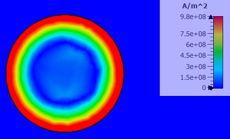

When an alternating current flows at high frequencies in a solid wire, there is a redistribution of the current within the conductor. The current density is largest near the outer surface of the conductor and decreases exponentially toward the inner axis of the conductor. This redistribution is the skin effect. The expression for the skin depth δ is given in (1) and its effect is shown in Figure 1. The outer red cross-section in Figure 1 carries the highest current magnitude while the central blue section carries the lowest current magnitude, which is due to redistribution of current flow inside the whole cross-section of the conductor. The skin depth, δ, is therefore the depth where the current density is 1/e of the value at the surface.
Figure 1. Skin effect in AC-carrying conductor
This causes an increase in resistance of the conductor due to reduced cross-sectional area of current flow, and therefore resulting in an increase in heat losses. Using litz wires in such cases helps mitigate the skin effects but does not eliminate it; hence why it must be taken into account.

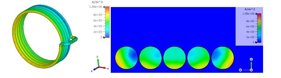

Another significant issue to consider when using litz wires is the proximity effect due to the closeness of packed wires. The proximity effect also causes a redistribution of currents within the conductors and hence an increase in AC resistance, resulting in an increase in heat losses. Figure 2 shows how the proximity effect affects current distribution in a coil with five turns. Figure 2 (a) shows the full coil, and Figure 2(b) the current distribution in the cross section. Twisting the wire strands into a bundle using an appropriate lay length and number of twists can help reduce the losses due to the proximity effect, but does not eliminate them. Hence, we must also consider them.
Figure 2. Proximity effect in AC carrying coil (a) Full coil with five turns, (b) Cut in YZ-plane

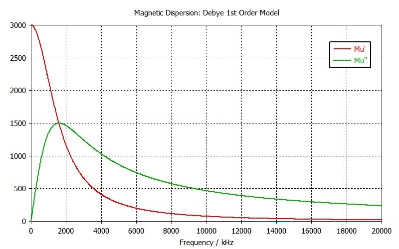

The relative magnetic permeability of the ferrite core is set to 200, and it has dispersive magnetic properties, as shown in Figure 4. This allows the calculation of the frequency-dependent magnetic losses in the C-core, which are not discussed in more detail here as it is beyond the scope of this paper.
Figure 4. Debye 1st Order Model for magnetic dispersion in Ferrite C-core

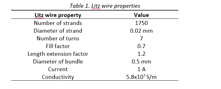

The coil is defined using ‘Coil Segment’ option and hence is by default an open coil loop. To have a divergence-free current in the coil, it must be closed either using a perfect electric conductor (PEC) or using the boundaries of the model. In this case, PEC is used as material to close the loop, as shown in Figure 3. This does not affect the losses in the model, but the PEC material can later be changed to a more realistic one to represent the electrical connector between the two wire ends. Once the coil is created, the properties can be defined in the dialog box, as shown in Figure 5. Table 1 provides more details on the litz wire coil used in this example.

In general, the number of strands found in a litz conductor can range from a dozen to thousands. The strand diameter must be given without the insulation thickness and the software calculates the fill factor and conductor area, based on the cross-sectional area of the geometry of the coil. Usually, the maximum strand diameter chosen is twice the skin depth of the wire material used at the highest operating frequency. However, this is not always enough to eliminate skin losses, as real power supplies usually contain higher noise harmonics, depending on the application. The length extension is the ratio of the real total length of the litz wire (before twisting) to the measured final length (after twisting). This method assumes that the current is homogeneous at bundle level. Most industrially wound Litz wires have the strands twisted and woven in an optimized way to have the current as homogeneous as possible.

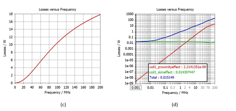

The model is solved for a frequency range of 50 Hz to 200 MHz, and the results for each frequency point can be found in the navigation tree, as shown in Figure 6(a). The main results of interest, skin and proximity losses, can be found under 1D Results/LF Solver/Losses. In this example, the losses in the ferrite C-core are also available. Figure 6(b), 6(c) and 6(d) show the skin, proximity and total losses respectively.
Figure 6 (a) Results in the navigation tree, (b) skin losses, (c) proximity losses, (d) total losses
In Figure 6(b), we see the skin losses are relatively constant throughout the frequency range, except for the slight dip around 100 MHz. The relatively constant value is expected as the strand diameter is chosen (Table 1) below 2δ (two times the skin depth) up until a frequency of 100 MHz.
In Figure 6(c), we see an increase in proximity losses with increasing frequency, as expected. The magnitude of the proximity losses is large compared to the skin effect, as expected due to the diameter of strands chosen.
Figure 6(d) shows the total losses, including the ferrite C-core losses in logarithmic scale so that the values for the whole broadband range are visible. The legend shows the value of each loss at 50 Hz, which is the lowest simulated frequency. The slope is dominated by the ferrite losses, but the effect of the AC current losses is still significant, especially the proximity losses.

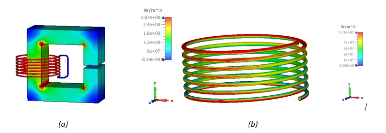

Figure 7(a) shows the magnetic loss density in the complete model at 100 MHz, while Figure 7(b) shows the loss density in the coils only, dominated mostly by the proximity effects. Despite the losses being much higher in the ferrite core, the loss density is much higher in the coils due to the smaller cross-sectional area.
Figure 7. Magnetic Loss Density (W/m3) at 100 MHz in (a) Complete model, (b) Coils with dominating proximity losses
