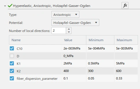

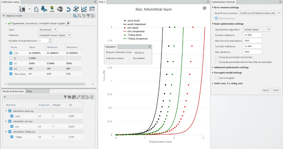

First, become familiar with the SIMULIA Community post shown above and run this calibration using the normal approach.  Units used are N, mm, MPa.  Then start the surrogate approach by setting these values for the parameters. The use of NN surrogates requires bounds be set for all active design variables.   Be sure to cache these initial parameter values.

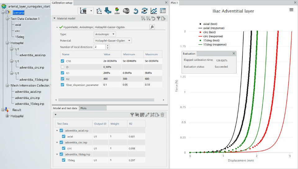

Then run an "Evaluate", getting this:

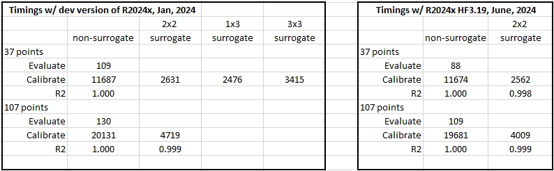

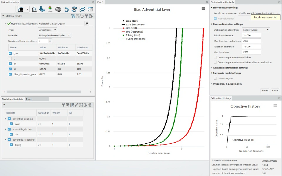

From this starting point, a normal calibration, with default settings (no surrogates) takes 20,130 secs and recovers the 4 parameters exactly.
The number of function evaluations, 204, is the number of Abaqus runs made.

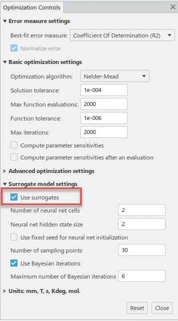

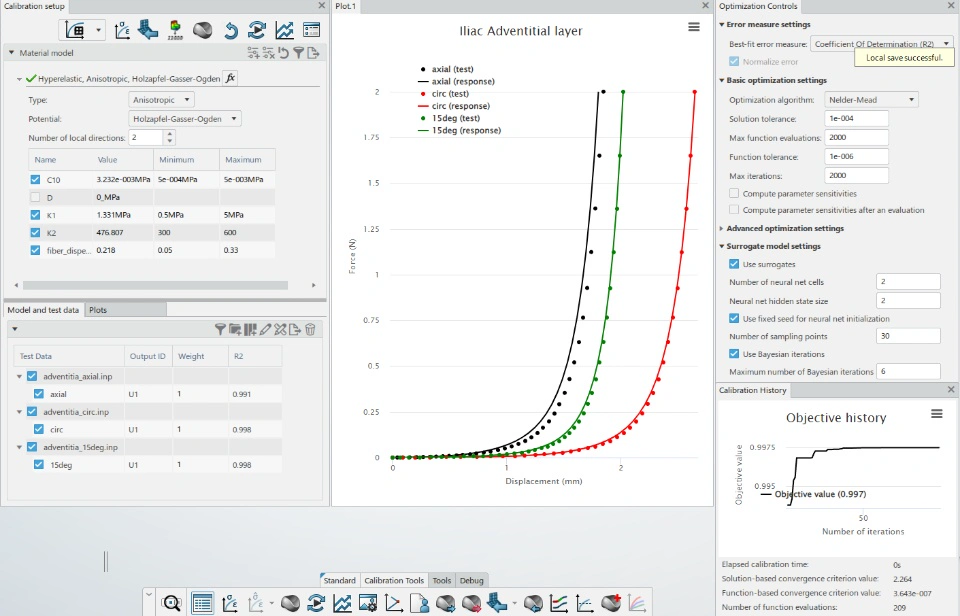

Now, under the Optimization Controls, select to "Use surrogates"
This UI option is only displayed if you add SMAMATCAL_SHOWSURROGATES  in your Env.txt file.

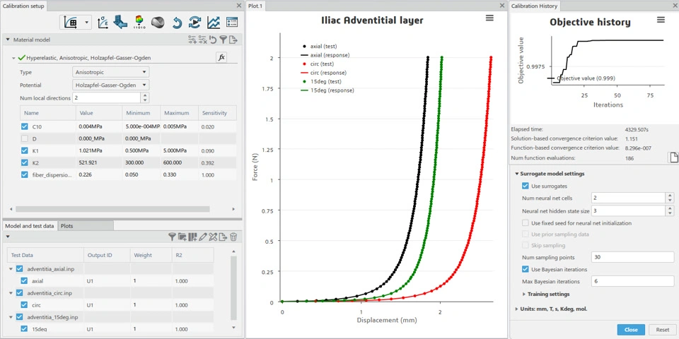

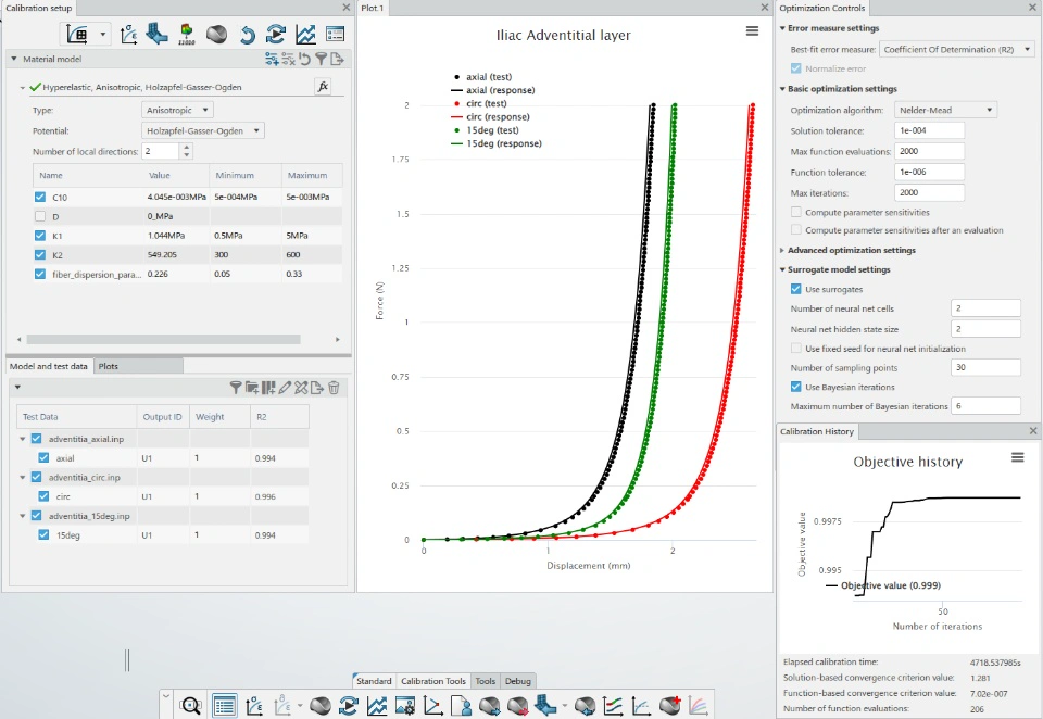

Execute a calibration using all the default values for the surrogate option.
Note that there is a discrepancy between the aggregate R2 = 0.999 and the individual R2 values. This is a known issue.
Here is the surrogate calibration run using a dev. version of R2025 GA, run on June 2, 2024.
 The performance is about the same.  The surrogate default values are a bit different.

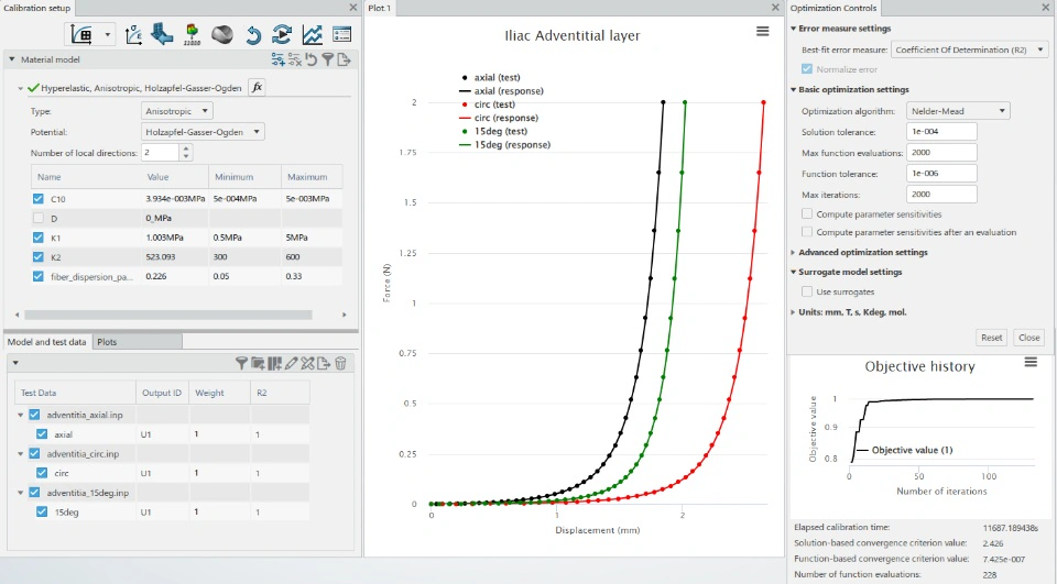

In the work above the 3 test datasets had 106, 107, 107 datapoints. I have regularized the datasets to have 37 points, and run an Evaluate here:
Run a regular calibration:
Run a surrogate calibration:   There is currently (dev version, Jan 9, 2024) a bug here with reporting the calibration time (shown as 0s). The calibration time is 2631 seconds.
Using fewer data points makes a big impact (2x) on the total time of the calibration.
Using the NN surrogate approach can reduce the total time by about 4x.

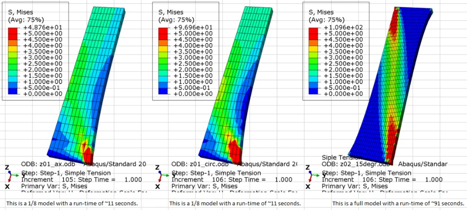

In the example above we show two ways to improve performance, use fewer test data points and use NN surrogates.  Now we are going to discuss using more cpus / using parallelism.   Recall that we are using 3 different Abaqus models.  Two of them run in about 11 secs and the third, the adventitia_15deg one, runs in about 91 secs. We can edit the mesh/model using this dialog and change the number of cpus used to run this particular Abaqus model.
First, we should run that 15deg model outside the platform and see how much speed-up can be achieved with various number of cpus.  I used Abaqus 2025HF1 to investigate this:
Setting the "Num CPUs = 4 for the adventitia_15deg model causes the Evaluate time to drop from ~102 secs to ~44 secs.  (R2025HF1.23 on April 15, 2025).  My laptop only has 6 cpus, so I don't see any point in making this larger than 4.
