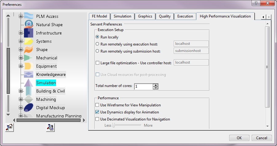

Hi All,
When using the On-Cloud implementation of High Performance Visualization (HPViz) in 3DX, if "Use cloud resources for post-processing" is not checked then the servant will run locally and use the number of cores selected for local setting. The cloud implementation of HPViz servant is limited to 1 core in R2014x.
 Note that:
  • For multi-core with local visualization the local system must have MPI installed.
  • For multi-code with remote visualization, the remote system must have MPI installed.
  • For cloud, currently only single core is supported.
