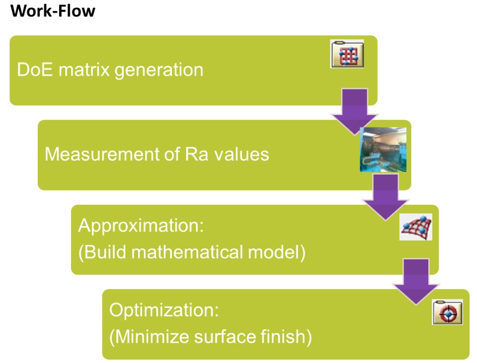

Key Isight Features and Benefits
  • Design of Experiment (DoE): To create experimental data
  • RSM: Build mathematical model
  • Optimization: Approach to obtain the machining conditions for the required surface finish
Workflow
 The actual experiment spanned across complete surface of the axle pin, but the blog here explains optimization process for a single location within the span of the pin.
