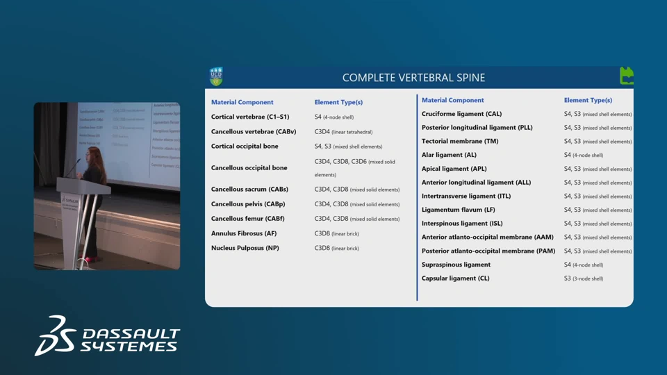

The Total Human Model for Safety (THUMS), developed by Toyota Corporation, is a highly biofidelic finite element (FE) model widely used for biomechanical analysis.
Originally designed for different simulation platform, THUMS was adapted for use in Abaqus for this study. Given the focus on forward head posture, the model was further modified to retain only the vertebral column while preserving geometric integrity.
To validate this adaptation, initial simulations employed static structural analysis, assuming isotropic elastic materials. However, enhancing biomechanical accuracy requires incorporating hyperelastic material properties for intervertebral discs (IVDs). A key challenge in this transition arises from THUMS’ intricate geometry, characterized by a high element-to-node ratio due to shared nodes among components. This complexity increases computational demands and may cause convergence issues when implementing hyperelastic materials.
This refinement is crucial for advancing toward dynamic implicit simulations, where accurate time-step management is essential for predictive human body modelling. Addressing these challenges will improve the model’s fidelity in representing spinal biomechanics under dynamic loads, enhancing its utility for impact and injury analysis.
This study outlines the methodology for material model transition, examines computational constraints, and proposes solutions to improve stability and efficiency in hyperelastic FE modelling. The findings contribute to optimizing THUMS for advanced biomechanical simulations, expanding its applications in injury biomechanics and human safety research.
