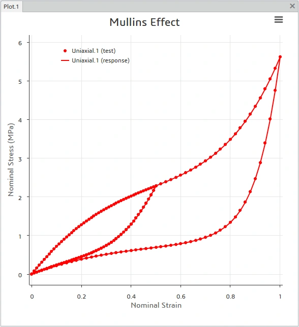

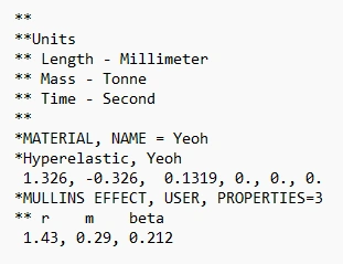

The test data shown above is "synthetic" data created by running Abaqus with this material model:
This post demonstrates the calibration of a UMullins user subroutine using the Numerical mode of the 3DExperience Calibration App. The UMullins user subroutine capability was added in R2025xFD01. The video below was created using the public cloud, R2025x HotFix 1.22  The Fortran source code for this example comes from the Abaqus Verification Manual, section "Mullins effect and permanent set". In this example I have used the environment variable SMAMATCAL_SHOWMULLINSDEPVAR=1 so that the user interface will allow the user to input "Number of solution dependent variables" (DEPVARs).
