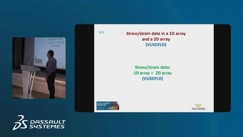

  4. Stress/strain data in a 1D array and a 2D array
