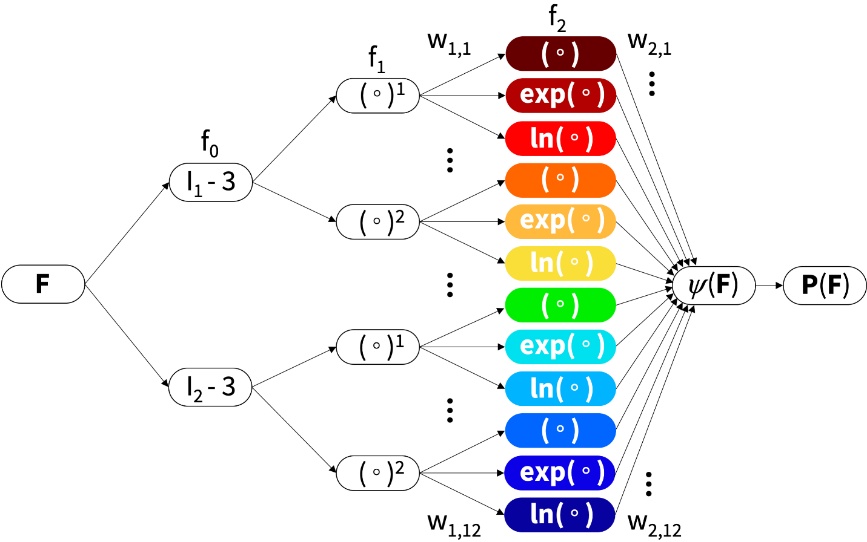

Figure 1: Constitutive artificial neural network for automated discovery of isotropic, perfectly incompressible, hyperelastic material behavior.
Stanford researchers developed Constitutive Artificial Neural Networks (CANNs), which leverage AI via an integration of physics and machine learning to enable automated model discovery. Developed by Kevin Linka, a former postdoc at Stanford and now a professor at RWTH Aachen, the CANN method automates the selection process from over 4,000 models. While such selection was previously based on user experience and personal preference, the network autonomously selects the best model, parameters, and experiment to characterize soft matter systems.

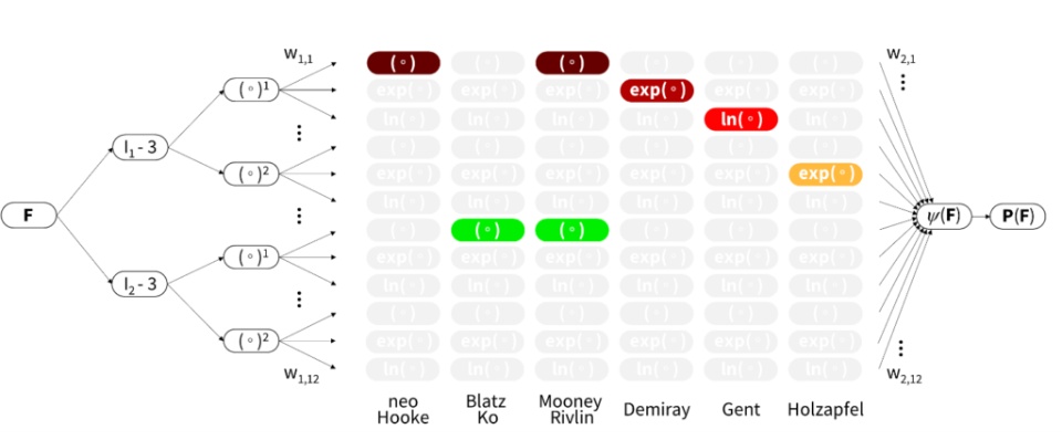

Figure 2: Classical constitutive material models form special cases (deactivated terms shown in gray) of the myriad of constitutive models that can be autonomously discovered using the full constitutive artificial neural network.
“We challenge the conventional wisdom to first select a constitutive model and then fit its parameters to experimental data,” explains Ellen Kuhl, professor of mechanical engineering at Stanford specializing in machine learning and living systems. “Instead of using classical off-the-shelf neural networks, we reverse engineer our own network from a set of functional building blocks that are, by design, a generalization of widely accepted models.”

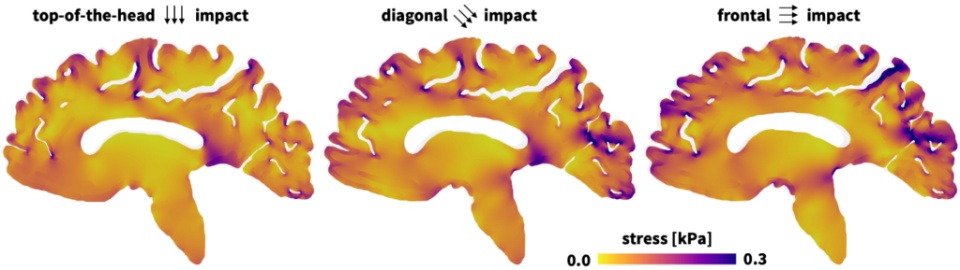

Figure 3: Stress profiles for top-of-the-head, diagonal, and frontal impact on the human brain.
“One of the nice features of the Constitutive Artificial Neural Network is that it is constructed to produce models that obey the laws of physics. But the most powerful part is that it can generate material models that don’t currently exist—and are now included—in the Abaqus material library,” explains Hurtado. “When combined with the Universal Material Subroutine, we can validate that the response is correct for simple deformation modes and then use it for these bigger three-dimensional models of a brain.”

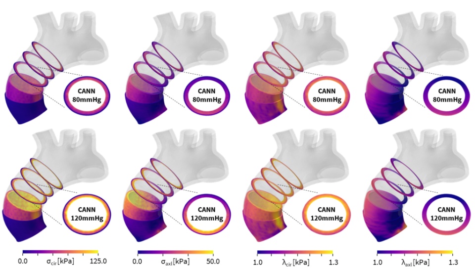

Figure 4: Diastolic and systolic stresses and stretches in the human aortic arch predicted by the newly discovered constitutive material model.
Before working with the Abaqus team, Peirlinck had to write his own code if a discovered model did not exist in the material library. After collaborating with Hurtado and the Abaqus development team, the Universal Material Subroutine guarantees that every model discovered by the CANN can be seamlessly implemented into Abaqus. “Abaqus always did a good job of bringing in the latest new constitutive models that were out there. However, now we are not limited by the material library because you can basically use any new model that you discover and then automatically integrate it into your FEA pipeline,” enthuses Peirlinck. “I think this will democratize the usage of finite element analysis for less experienced people like our medical collaborators.”
