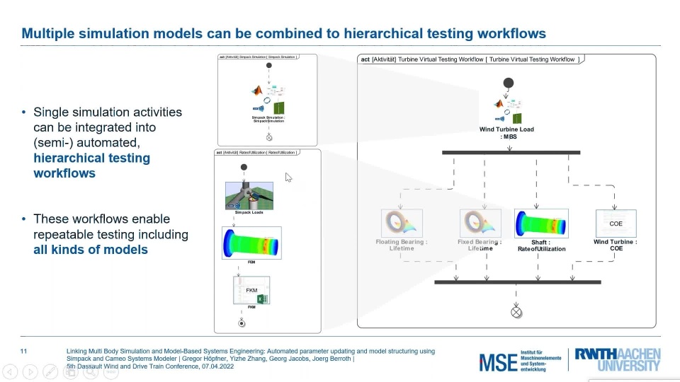

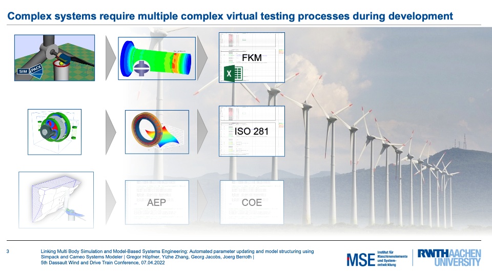

Towards Linking Multi-Body Simulation and Model-Based Systems Engineering: Automated Parameter Updating and Model Structuring using Simpack and Cameo Systems Modeler/SysML
Abstract:
Reduced time to market, rising system complexity and costly test procedures increase the need for virtual testing upfront validation. Therefore, complex systems are described in various models. Creating such models and keeping data consistent is effortful. Model-Based Systems Engineering (MBSE) is a method to manage system complexity and information by linking data in product development from requirements to the models that describe the solution space of a system. MBSE system models describe a system in a formal language, e.g., SysML. Simulation models can be (semi-)automatically integrated into SysML to test requirement fulfillment. We show an approach on how to link SysML system models in Cameo Systems Modeler with Multi-Body Simulation (MBS) models in Simpack using the example of a Wind Turbine. A SysML model is presented describing the Wind Turbine. An MBS model is linked to this SysML model, and it is demonstrated how parameters in MBS are automatically updated from the SysML. Additional models from other tools are integrated, creating executable virtual testing workflows making virtual testing repeatable. Thereby, modeling effort is reduced, and data consistency is ensured.
