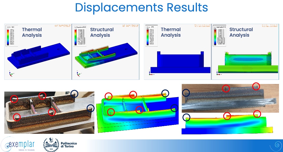

Thermo-Mechanical Modeling of the Directed Energy Deposition (DED) Process for the Optimization of Deposition Strategies
​​​​​​​The directed Energy Distribution (DED) process involves a continuous and subsequent deposition of layers by means of a laser heat source that melts the feedstock material supplied in the form of powders or wires. Laser power, powder flow rate, and travel speed affect temperature gradient distribution and residual stresses in components. Due to this, the main process parameters’ influence on DED process was investigated, followed by fine-tuning.
The main objective of this work was to compare four simulations with different scanning strategies for the to-be-printed component, focusing on deformation results. To achieve this objective, the 3DEXPERIENCE software was essential in simulating DED process accurately. Setting up the Finite Element Method (FEM) model, mesh type, material properties, and boundary conditions followed a strict procedure.
As a final step, once the best case in terms of deformations from a production perspective has been highlighted, the component is subjected to post-processing machining to respect the designed dimensioning and tolerances.
