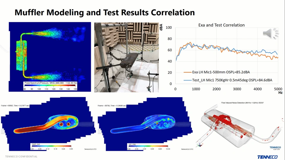

Exhaust systems are primarily divided into two subsystems: the hot end and the cold end. The hot end part of exhaust system includes components like manifolds, turbochargers, catalytic converters, DOC, DPF and SCR systems with dosing module and mixers. The cold end part of the exhaust system includes resonators, mufflers, tailpipes, and other devices for attenuating engine and flow noise. This presentation will focus on the computational method used at Tenneco for developing and validating cold end system to meet overall flow noise targets. Examples of exhaust system modeling for different components will be presented and, in some cases, test results and correlation will be discussed.
