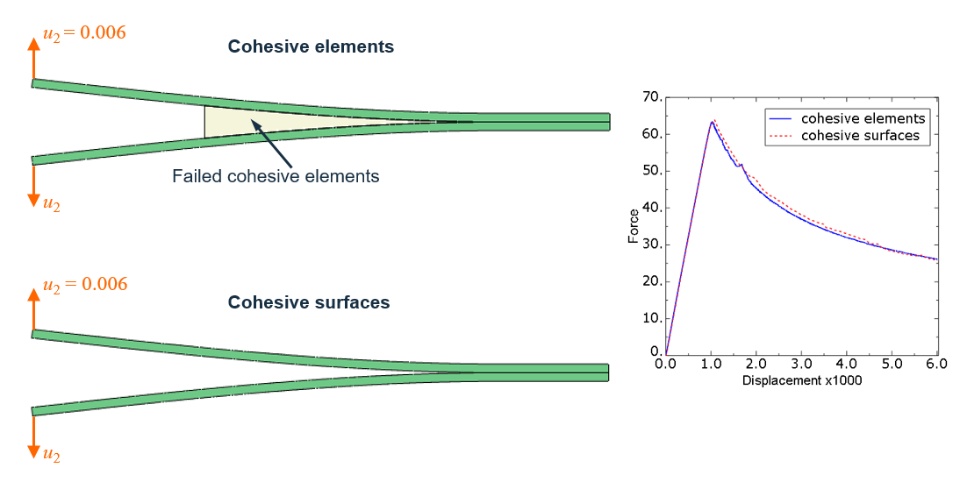

This is a 2D model, using cpe4i plane strain elements for the beams and coh2d4 cohesive elements to model the adhesive bonding the beams. Runs in about 130 secs on my laptop.
DCB - Double Cantilever Beam, from Workshop 4
