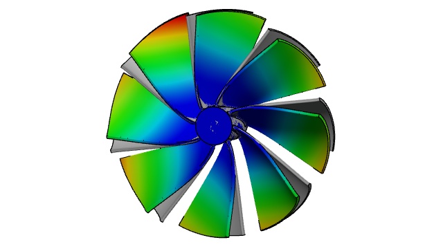

A new simulation example entitled “Frequency Analysis of a Fan Propeller” is available with the R2022x FD03 release of the user assistance. This example teaches you how to save a SOLIDWORKS part (shown in the image) to the 3DEXPERIENCE platform and create a frequency simulation using the Linear Structural Validation app.
You begin the example by saving the fan propeller to the 3DEXPERIENCE platform directly from SOLIDWORKS Connected. Next, you create a frequency simulation in Linear Structural Validation to evaluate the natural frequencies and modes of vibration of the propeller. To qualify your design, you verify that the propeller's natural frequencies do not coincide with the rotor's excitation frequencies. Finally, you create a bookmark for the simulation results to share them with your team.
