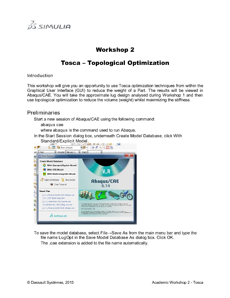

If you have the SIMULIA Academic Research or Teaching Suites at your institution and you would like to get started using the Tosca optimisation package, here is a simple step-by-step workshop example that will show you how to:-

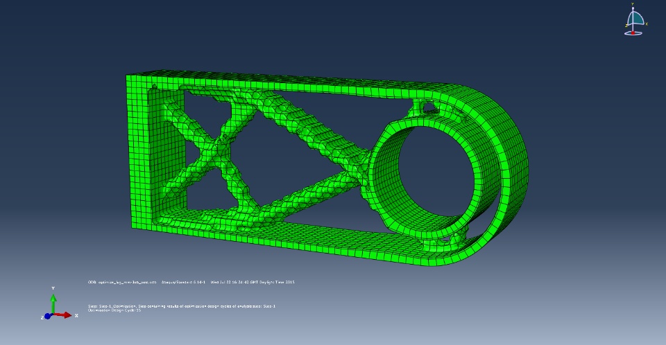

use Tosca optimisation techniques from within the Graphical User Interface (GUI) to reduce the weight of a part whilst maximising its stiffness.
If you were successful with the first workshop in this series, the Simple Abaqus Workshop (https://swym.3ds.com/#post:38837 ), then you will already have created and saved the Lug part geometry needed for this Workshop. If you are jumping straight in to the Workshop series here don't fear, we have attached the necessary part file 'Lug.sat' to this post.
Remember to save the relevant files at the end for the Tosca Shape Optimisation Workshop which will follow this one.
