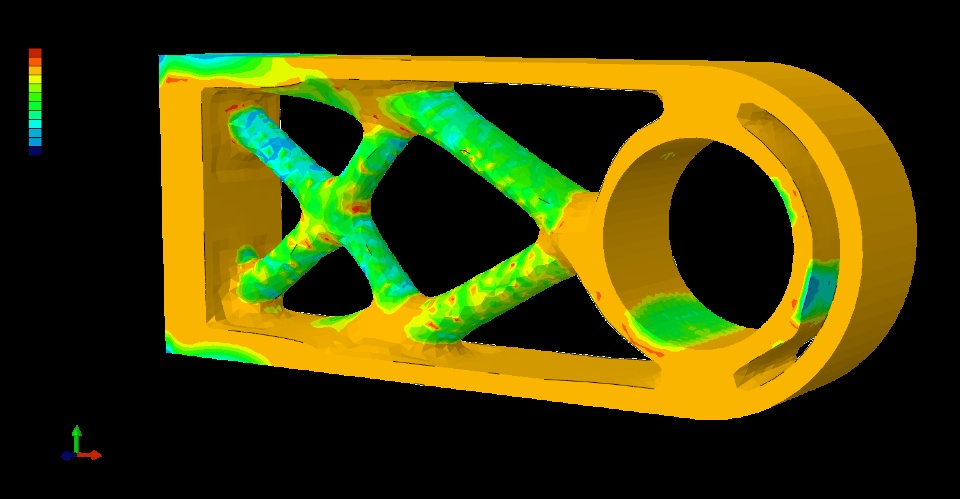

Simple fe-safe Workshop to get you started :) Lug Design Workshop #4 - fe-safe
If you have the SIMULIA Academic Research or Teaching Suites at your institution and you would like to get started using the fe-safe fatigue and durability package, here is a simple step-by-step workshop example that will show you how to:-
use fe-safe to open an Abaqus .odb; specify material fatigue properties and run a simple load history to determine the number of Repeats. Then examine the effect on life of using a more durable material.
