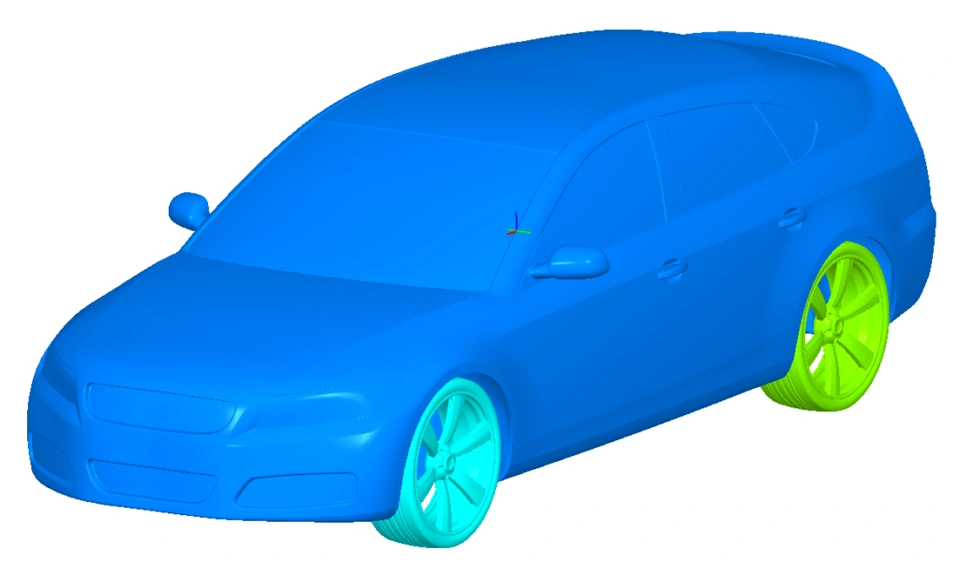

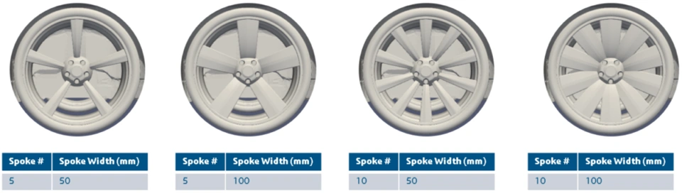

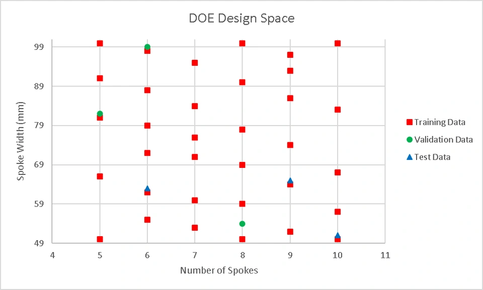

As a use-case, the following optimization study is analyzed: a design-of-experiment (DOE), where the tire spoke number and spoke width of the open-source DrivAer car geometry (see figure 3) are varied, with the optimization goal being the identification of the lowest vehicle drag configuration. In figure 4, the DOE design space is depicted. Red squares represent the simulation set that is used to train the ML models, green circles are the validation data points used in the ML training process to observe ML model convergence, and the blue triangles represent the blind test sets that will be used to see how well the ML models generalize to unseen vehicle geometries. The design space extremes are illustrated in figure 5.
Fig. 3: DrivAer car geometry
Fig. 4: DOE design space
Fig. 5: Design space extremes

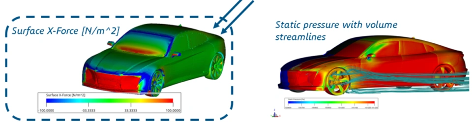

Fig. 6: Flow and surface field representations from the PowerFLOW simulation – the one of interest for this study is the surface X-force distribution (sample data is shown for the 3DS E-car geometry)

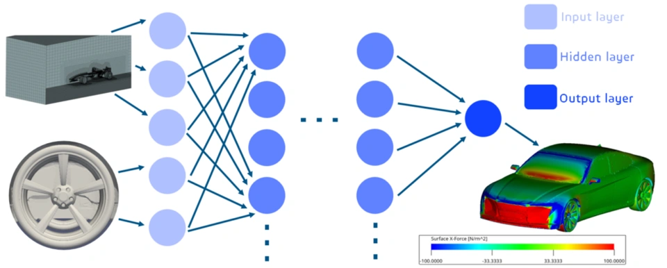

The study can be broken down into two segments: the CFD portion and the ML model part. During the CFD phase, 40 high-fidelity simulations are prepared in PowerDELTA, set-up in PowerCASE, run with PowerFLOW and some results are subsequently visualized in PowerVIZ as a sanity check that the data is reasonable. Each simulation takes about 6 hours and requires up to 300 CPU cores. Sample aerodynamic result visualizations are depicted in figure 6 for the Dassault Systèmes (3DS) E-car geometry. For this study, the critical surface field representation is the surface X-force distribution. Once the CFD data is collected, 34 simulation points are used to train deep learning neural network models that are written in Python with 3 simulation points used as validation points. A schematic of the feed-forward neural network models applied is depicted in figure 7 with the output data again represented by the 3DS E-car geometry. The input layer of the neural network models is fed with x-, y-, and z-coordinate data, as well as the spoke number and spoke width. This information is then propagated through the hidden layers of the neural network and, finally, at the output layer one obtains the surface X-force distribution of the vehicle. Training the neural network models takes approximately 3 days on a Windows workstation with a single GPU card. Meanwhile, the inference step, where the surface X-force distribution for vehicle geometries not seen during the neural network model training phase is predicted, merely takes several minutes.
Fig. 7: Schematic of the deep learning neural network models used in this external vehicle aerodynamics DOE study (sample output is for the 3DS E-car geometry again)

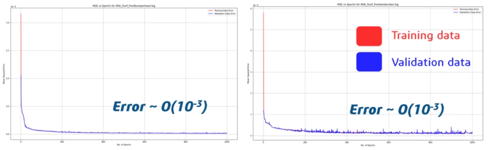

Before assessing the predictive capabilities of the trained ML models, it is imperative to check that the models are not under-fitting nor over-fitting the training data. This is done by looking at the mean-square-error (MSE) of the models as a function of training epoch. Two sample plots are provided in figure 8. Although for the 3DS E-car, similar orders of magnitude were achieved for the DrivAer car study presented in this article. Evidently, the MSE decreases almost monotonically and stays low as well, illustrating that the models should generalize well when exposed to unseen vehicle geometries. Furthermore, the MSE has an order of magnitude of O(10-3), which is reasonable as well.
Fig. 8: Sample MSE plots (for the 3DS E-car geometry)

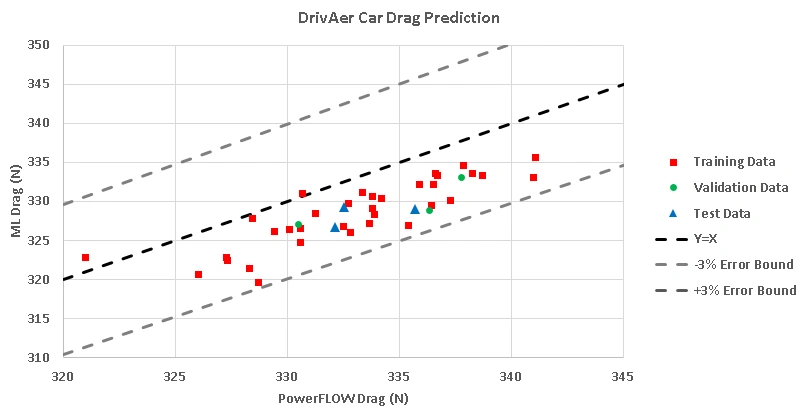

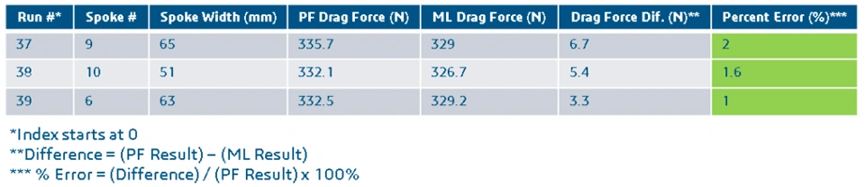

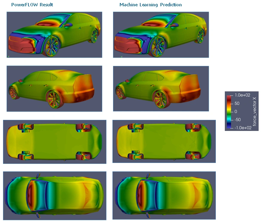

Now, one can look at the ML models predictive capabilities. For the blind test points, table 1 shows the drag force deltas between the true PowerFLOW results and the ML model outcomes and, more importantly, the percentage error. Evidently, the percentage error is around 2% for all three test cases, which is a very good outcome. Beyond that, the trained ML models were applied to all simulation points: training points, validation points, and test points. The associated accuracy of the predictions is depicted in figure 9. Here, one can clearly see that the error lies within the 3% error bound. It is also interesting to note that there is a bias in the ML model results; the ML models consistently under-predict the integrated drag force. Having looked at the integrated drag force, surface X-force distribution plots provide further insight into the predictive capabilities of the ML models. Figure 10 shows these surface contour plots from different angles and viewpoints for run 37 (similar plots are obtained for all other runs). It is quite clear to see that there is almost no difference between the true PowerFLOW results and the ML predicted results. This substantiates the claim that the ML models are good surrogates for expensive high-fidelity PowerFLOW aerodynamic simulations.
Table 1: True PowerFLOW drag force vs. ML model predictions for the test points
Fig. 9: Overall predictive capability assessment of the ML models
Fig. 10: PowerFLOW result vs. ML result for surface X-force distribution of run 37
