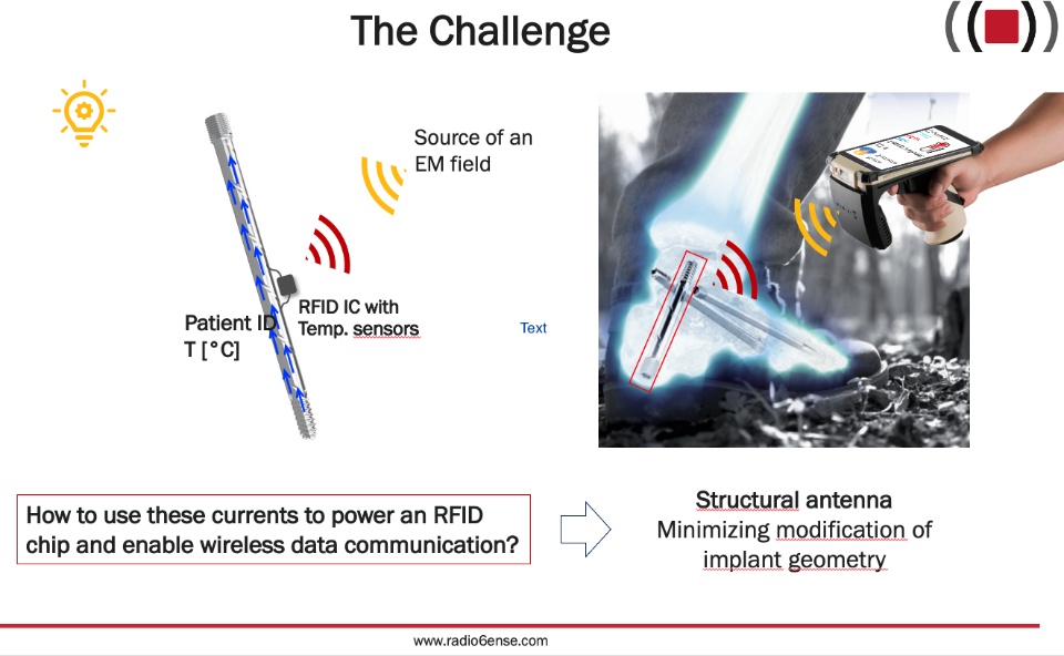

Digital Transformation is turning conventional medical devices into data generators, thus leading toward the new paradigm of Digital Health. This trend primarily involves orthopedic prostheses that suffer from severe complications, such as post-surgery infections that could be detected early through built-in sensing features. As orthopedic prostheses are predominantly made of metal, leveraging structural antenna theory allows for conveying of currents induced by an external electromagnetic source to power an RFID-based sensor. The challenge lies in implementing an antenna on a metal prosthesis to ensure through-the-body communication. The use of EM simulation tools plays a crucial role in identifying the best solution for prosthesis antennification, considering the cohabitation with the human body, which has an unavoidable impact on communication performance. Simultaneously, it is essential to understand the effects of geometric changes on the mechanical robustness of the prosthesis. Therefore, utilizing simulation tools that can easily interface with mechanical simulators within the same environment enables multiphysics numerical analysis up to creating the relative Digital Twin.
