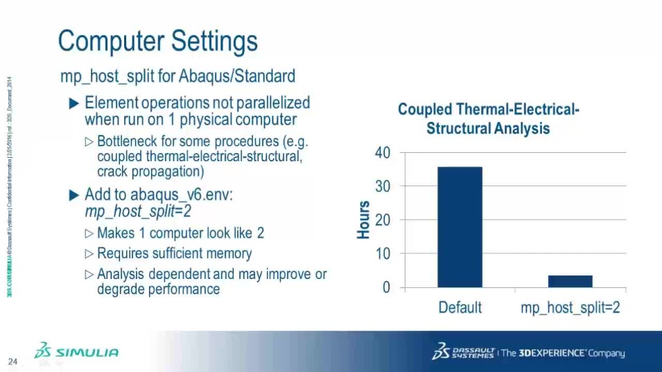

  • GPUs look like additional CPU cores with Abaqus licensing following the curve shown in the licensing portion.  At lower CPU core counts, each GPU used adds a solver token just like each additional core.
  • fe-safe needs 7 Extended Tokens to run a fatigue analysis.
  • Tosca needs a minimum of 5 Extended Tokens to run a linear optimization not counting the FEA solver.
  •  Isight needs 1 Extended Token to run an Abaqus DOE.  It is possible to run some simple loops using 0 tokens for Isight.
    • In the example of Isight savings with an Abaqus analysis using 10 tokens, the total token usage for an Isight DOE is 5 tokens (1 for Isight + 4 for Abaqus).
Remember that speed improvements are analysis dependent.  Try techniques on your own models to verify their effectiveness.
