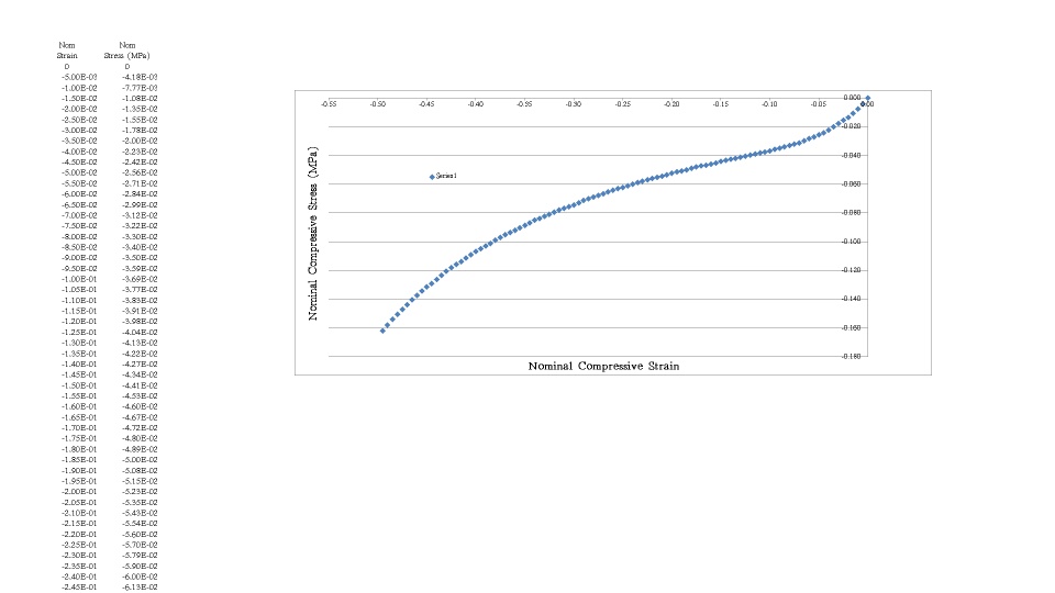

This paper is very interesting in part because the authors also shared publicly a large quantity of resilient foam test data.  The test data is for a large set of foams, and includes uniaxial compression, simple shear and volumetric compression testing.  The paper also makes the point that just testing a foam in uniaxial compression, then calibrating, may create a material model that behaves very incorrectly in shear.  It is also uncommon to see volumetric testing performed on a foam, which the authors do by way of a very interesting test apparatus (see video).
This Excel file contains just the "Poron cushioning" test data in Excel.  This test data was averaged by the authors and the

Here are their calibration values from their Appendix B, Table B.1
                                                              Mu         alpha     beta       nu
Poron                    UC          1             0.620     34.46     0.040     0.0370
Cushioning          UC+ SS 1                0.144     4.013     0.057     0.0512
Here are the responses from the app, using their parameter values (for UC only).  This matches their Figure 2 (upper row).    This is not a calibration from me, just using their parameter values.
Here are the responses from the app, using their parameter values (for UC+SS). This matches their Figure 2 (lower row). This is not a calibration from me, just using their parameter values.
