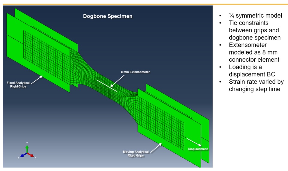

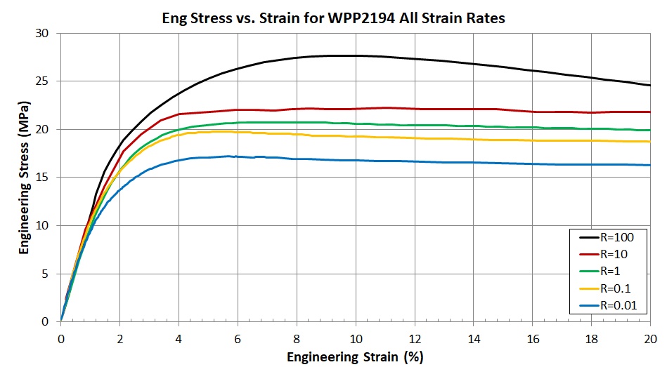

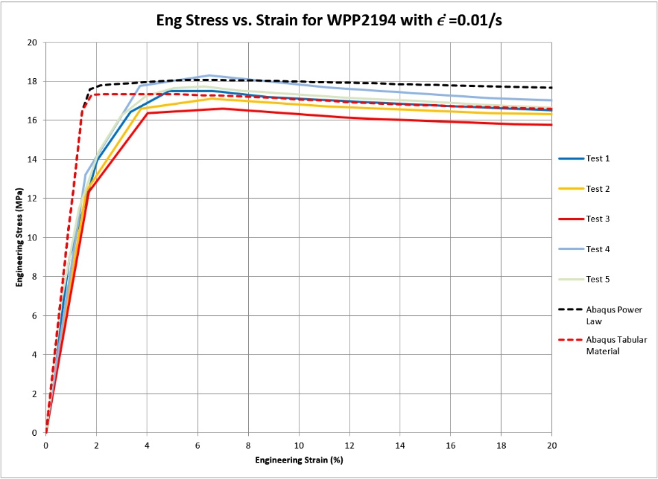

This test data was used for a one-day class originally developed back in 2012.  The attached PDF file is one section of the course notes. As time permits, we will redo the calibration using our new 3DX calibration app.
The PDF presentation below was developed for a one-day course in 2012.  This was before our 3DX calibration existed.  The PDF presentation shows a step-by-step calibration using several tools, followed by a validation phase using a dogbone simulation.
Excel file with the test data:
The zip file below contains an A/CAE file and .inp file for Abaqus:
