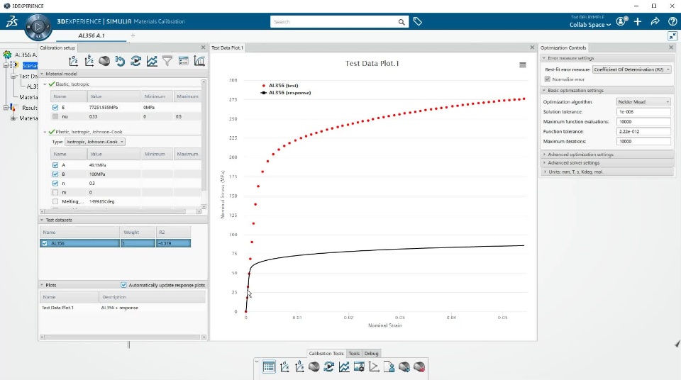

Here is a narrated video showing the calibration of a Johnson-Cook elasto-plastic material model to a single piece of uniaxial test data for an aluminum 356 material. The test data can be found here. This example uses the numerical mode.

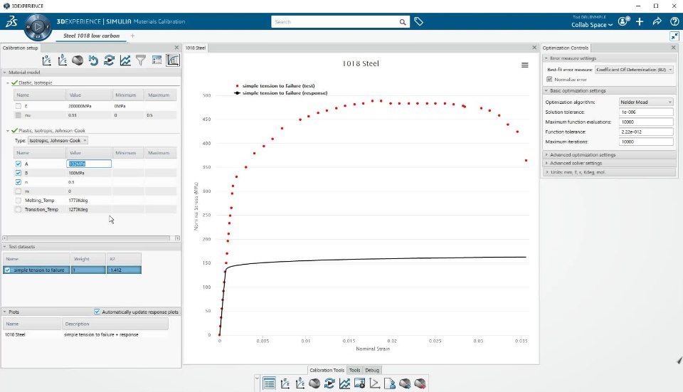

Here is another video of the calibration of an elasto-plastic Johnson-Cook material model.  This one is for 1018 low-carbon steel.  This test data is available here.  This test data shows a classic issue with the test, in that some slack was present in the test fixture and the first few data points are not correct, not believable.  The video shows how one would remove the first few points, correcting the data using the zero-shift capability of the calibration app.

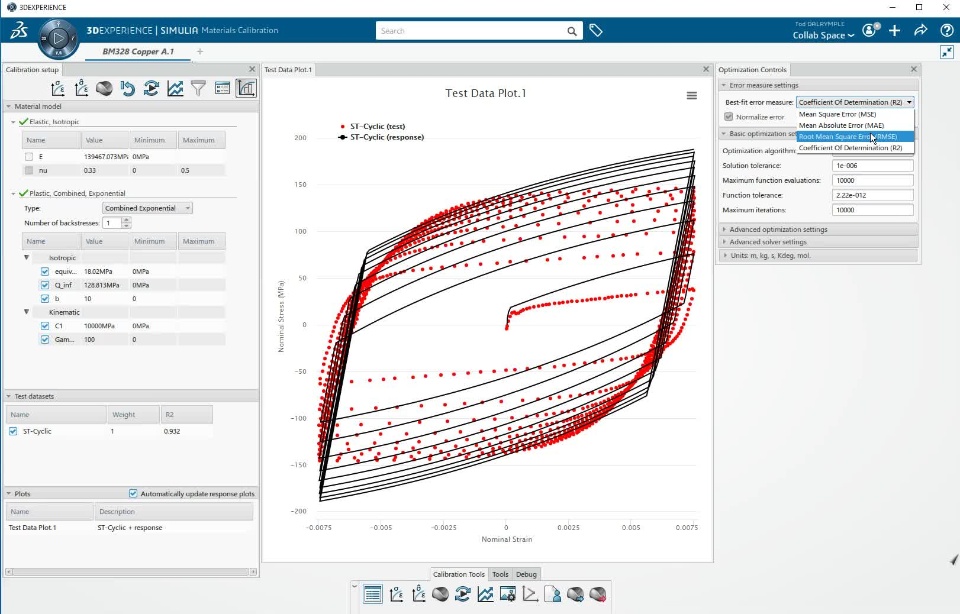

In metal plasticity, isotropic hardening is often used for cases like stamping (metal forming). But when the application involves cyclic deformations in the plastic regime, a combined hardening plasticity model is used to more accurately capture the behavior observed in reversed loading. Here is an example of fitting a combined hardening model to the cyclic test data of copper (from Benchmark Manual section 3.2.8).  The test data can be found here. This example uses the numerical mode.

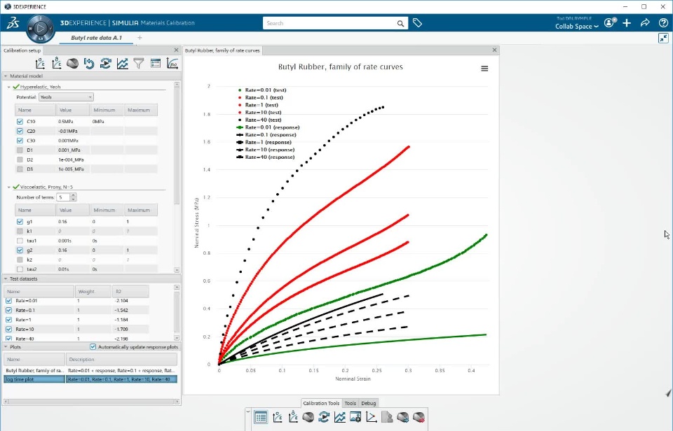

Here is an example of calibrating a Hyperelastic-Prony series model to a family of rate curves for butyl rubber.  The butyl rubber test data can be found here.  For applications such as drop testing, or crash, a family of rates is a common test data set to use as the basis for rate (time)-dependent material models. This example uses the analytical mode.

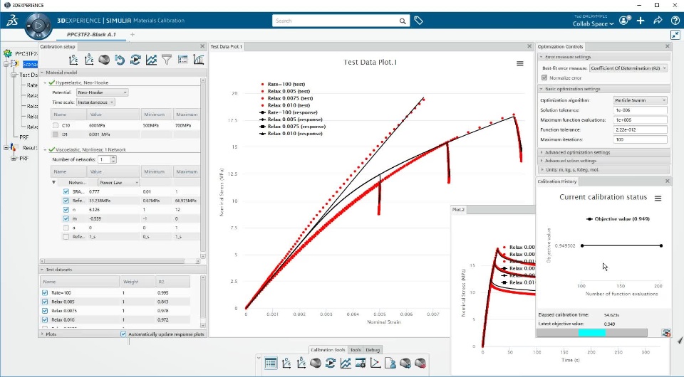

Here is a narrated video showing the calibration of a PRF material (parallel rheological framework) model for an automotive grade of polypropylene.   See this post for an Isight calibration that I did several years ago for this same material, and a fuller report on the polypropylene test data. The polypropylene test data is available here. In this video, I chose to try just one viscous network. This material model is available only in the numerical mode.
