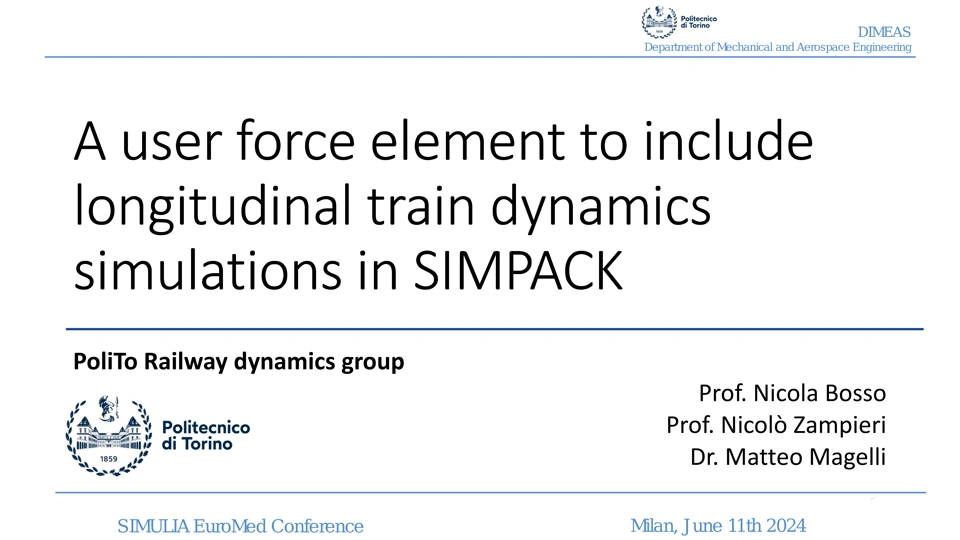

We were glad to have Nicolò Zampieri and Matteo Magelli from the Politecnico di Torino present at our EuroMed SIMULIA Conference 2024, on June 11-12, 2024, in Milan, Italy. Their presentation was titled "A User Force Element to Include Longitudinal Train Dynamics Simulations in Simpack".

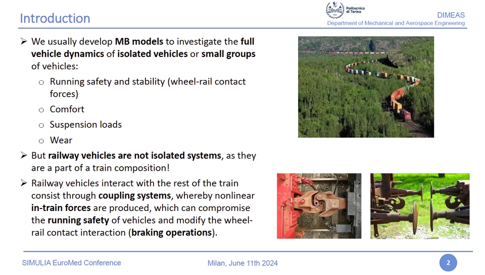

The present work shows the development of a specifically built user force element that can be included in any Simpack model to account for the effects of the train composition on the dynamic behavior of railway vehicles. The user force element is written as a FORTRAN90 routine and then compiled as a dynamic link library (DLL) so that it is available among the common Simpack force elements with the standard graphical user interface window. The force element solves the longitudinal train dynamics of a set of vehicles, providing the position and speed of each vehicle as dynamic states. In addition,, the user force element outputs the in-train forces and deflections on the vehicle connection system during the simulation. The new user force element is validated in the simulation scenarios of international benchmarking activity, and it ensures superior computational performances with respect to standard modeling strategies. The biggest benefit of the user force element is that it allows the efficient combine longitudinal train dynamics simulations and detailed multibody models of isolated vehicles/groups of vehicles, thus making it possible to assess the effect of the in-train forces on the wheel-rail contact forces and related running safety indexes within the same simulation environment.
