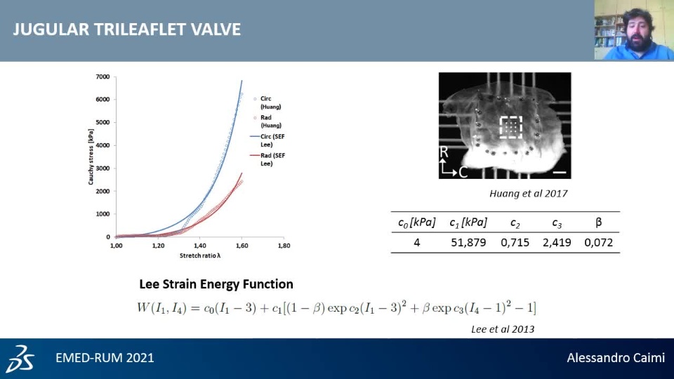

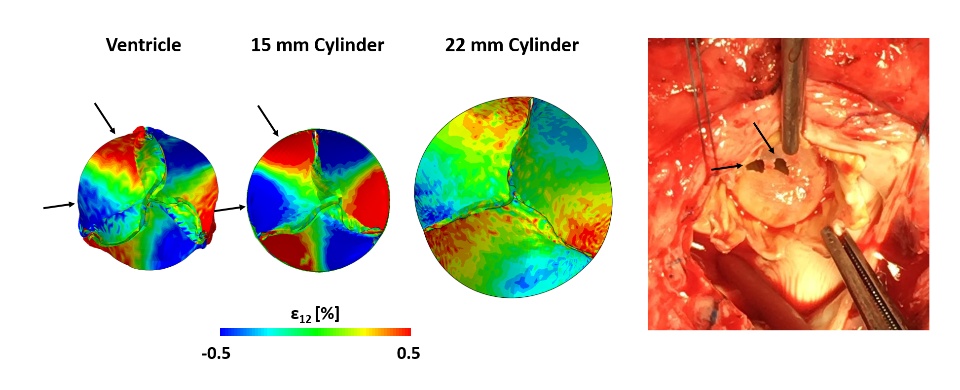

In pediatric patients, the standard treatment consists of the replacement of the valve with mechanical/ bioprosthetic devices or with autograft. However, re-replacement is inevitable due to patient growth. Hence, the surgical implant of an oversized stent-mounted valve, which can be percutaneously expanded after surgery, was proposed. Though this procedure seems to be promising, implant durability can be hampered by leaflet damage. Numerical simulations may assess the biomechanical impact of both device shrinking and left ventricle in vivo motion on the implanted device. The proposed finite element numerical framework, developed in ABAQUS/Explicit, proved able to couple a realistic numerical model of the inserted stent-mounted valve with the kinematics of the left ventricle, extracted from 3D ultrasound data, elucidating the effect of the procedure on the device. Our results suggest that valve undersizing dominates over annular dynamics in inducing biomechanically driven leaflet damage. This approach, if further tested, may support the improvement of the surgical procedure.
