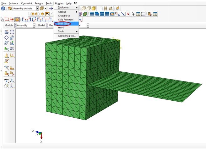

 3) Start Abaqus/CAE. You can access the plug-in in the Assembly or Interaction Module from the “Plug-ins” drop down menu.
Procedure on how to use the plug-in:
 1)  In Assembly or Interaction Module, select “Plug-ins--> Shell Edge”

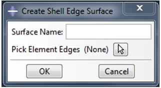

  2) Specify a name for the surface and click on "Pick Element Edges".

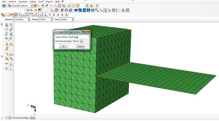

 3) To window pick only the free edges; user would need to select “Select from Exterior Entities" from the “SELECTION” toolbar (as highlighted below) so that it would only select shell free  edges.
4) After window picking the required shell edges, click “OK” in the dialog box and then “Done”.
5) Plug-in would have created a surface that would be listed under Surface Manager (as shown below)
