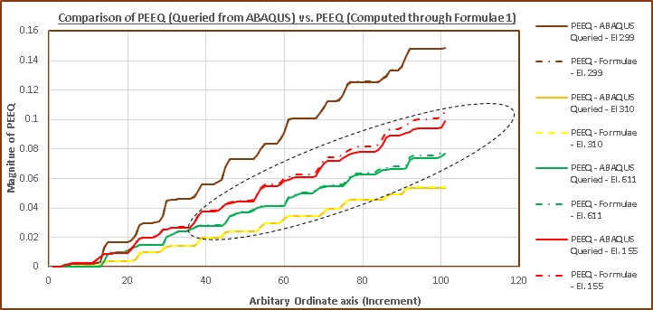

Although using the above formulae based upon Plastic strains is quite satisfactory for cases of Monotonic loading, this formulae might result in a fair bit of deviation between Abaqus determined PEEQ values and the PEEQ values got from the formulae for Sinusoidal loading cases as shown in the graph below (Graph 2). Hence, it can be safely said that the above formula can be successfully used only for Monotonic loading cases.
Graph 2: Comparison of PEEQ results (ABAQUS queried and Formulae 1) - Sinusoidal Loading
From the above graphs, it is shown that PEEQ determined in Abaqus​​​​​​​ is an accumulative quantity (never decreases). However, the formulae 1 when used for Sinusoidal loading cases not only gives a deviation in results but also fails to predict the correct accumulative nature of PEEQ.

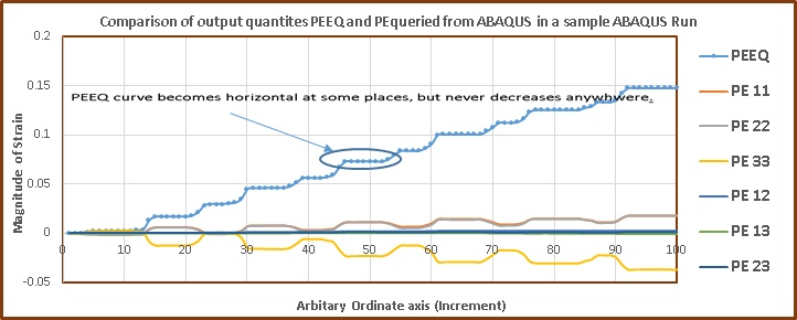

PEEQ Calculation on the basis of PE (Plastic Strain Components) for Sinusoidal loadings
The behavior that PEEQ values determined through the above formulae (formulae 1) does not correlate well with Abaqus queried PEEQ values for Sinusoidal loading cases is an expected one. This is because while individual Plastic Strain components (PE) go up during the loading phase and go down during the unloading phase, Abaqus PEEQ is an accumulative quantity. As visible in the below graph (graph 3) which contains output quantities directly queried from Abaqus, the plot for PEEQ becomes horizontal in some places and increases elsewhere but never decreases.
Graph 3: Comparison of PEEQ and PE quantities queried from ABAQUS

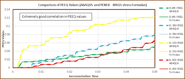

As PEEQ is the strain equivalent of Von Mises Stress, an alternative approach based on Von-Mises stress and PENER (The plastic energy dissipated per unit volume) is possible and was presented to the customer. The formulae for PEEQ on basis of MISES stress and PENER is –
Similar to Mises stress, PEEQ is a non-negative scalar quantity. This equation-based upon PENER would be applicable to any case irrespective of it being Monotonic or Sinusoidal loading or it is small or large deformations.  The corresponding PEEQ values calculated by this approach correlates extremely well with the Abaqus queried PEEQ values. The results from this approach are shown below in Graph 4.
Graph 4: Comparison of PEEQ results using PENER - Mises approach
