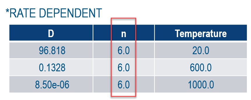

3)  There are some aspects of material models that contain exponents, and as one makes these a tabular function of temperature, the exponents ought to be held constant.  An example is *Rate Dependent :  here the exponent "n" at each temperature is best constrained to be the same value.

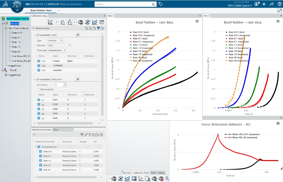

As a first release, we have tried to put some reasonable limitations in place to avoid optimization failures.  One example is that only parameters of the same unit may be related.  Another example is that the same parameter cannot be used in multiple relationships.  For this butyl rubber example, our starting point is the ending point of an earlier calibration:

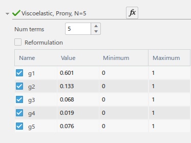

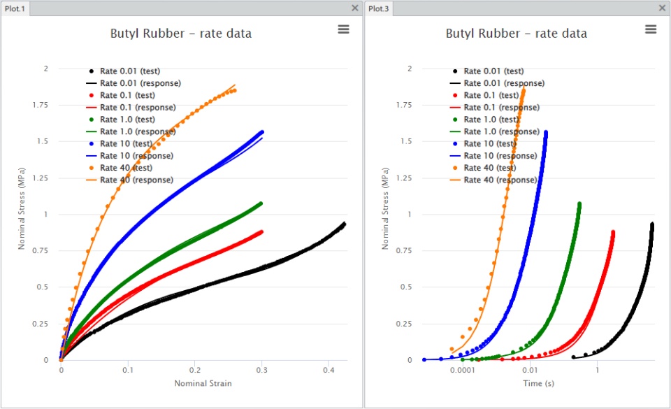

The above calibration was performed in analytical mode, then we changed to numerical mode in order to continue the work of adding some parameter relationships.  This state was saved as "Butyl_Rubber_Start.3dxml" (see attached zip file).  In general, this represents a good calibration result.  For the 5 test datasets, there is an R2 error norm of 0.993 or better.  However, as we look at the Prony "g" terms (the "taus" start at  1e-3 and end at 10), they do not monotonically decrease.

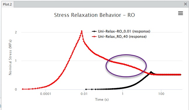

While we do not have any stress relaxation test data for this butyl rubber, we can use the RO capability to see what the stress relaxation behavior would look like for this hyper-Prony material model. In this plot window, I have shown two stress relaxation loadings, I want to focus on the red line.

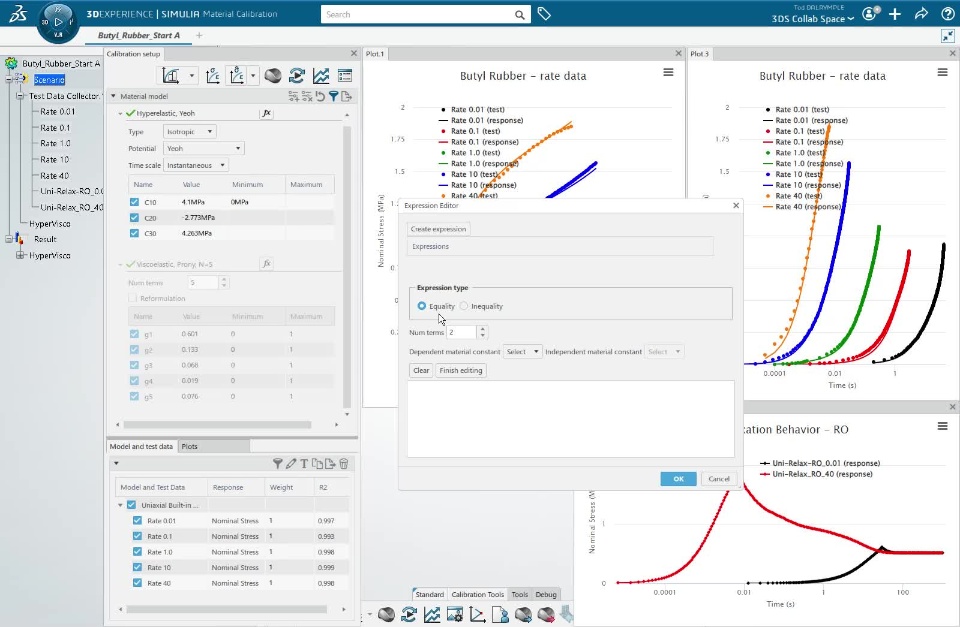

Here is a short video showing the creation of the relationship :  g1>g2> g3> g4>g5
