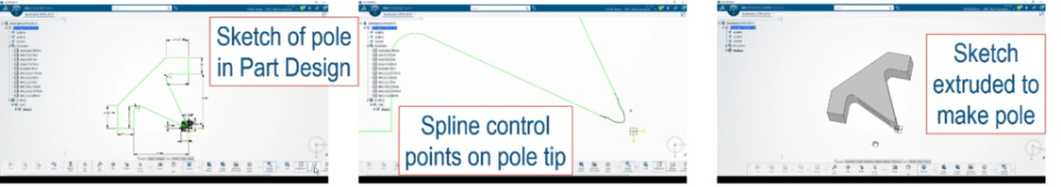

Design
A single pole of the magnet was first modeled using the CATIA app Part Design on the 3DEXPERIENCE platform. The pole was fully parameterized, particularly the pole tip that was to be the focus of the following optimization.
Figure 1: The design of a magnet pole in the CATIA Part Design app.

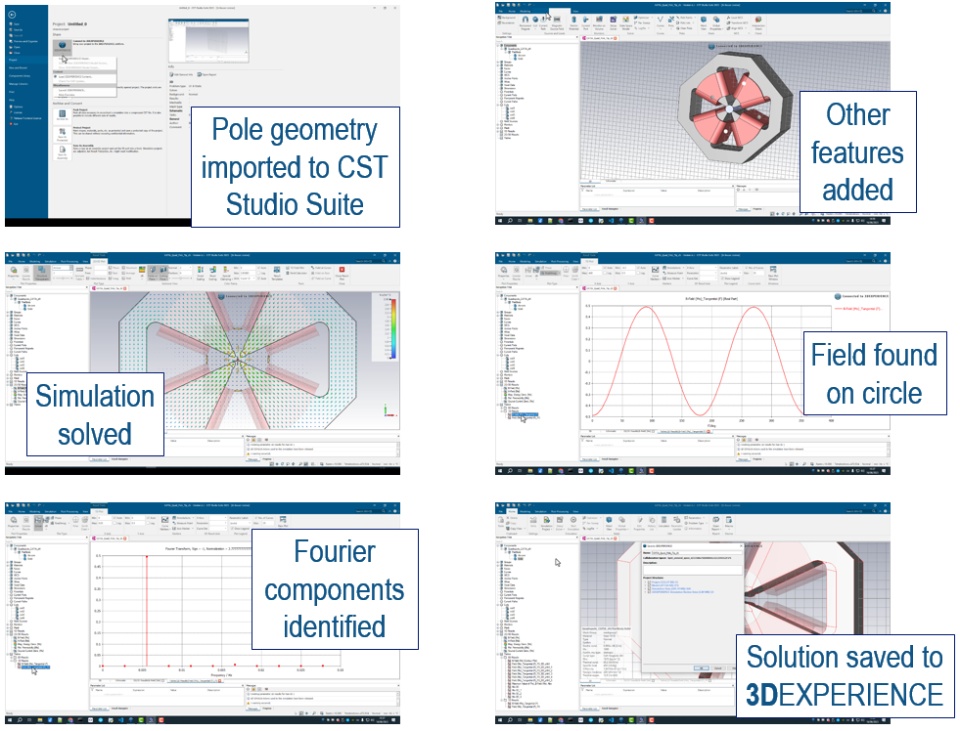

Simulation
Using the 3DEXPERIENCE platform, the part was imported into CST Studio Suite. Symmetry was used to create the rest of the quadrupole. Coils, mesh, boundary conditions and analysis options were added. The Magnetostatic solver was run and post-processing conditions defined.
Figure 2. Setting up and solving the electromagnetic simulation of the quadrupole magnet.

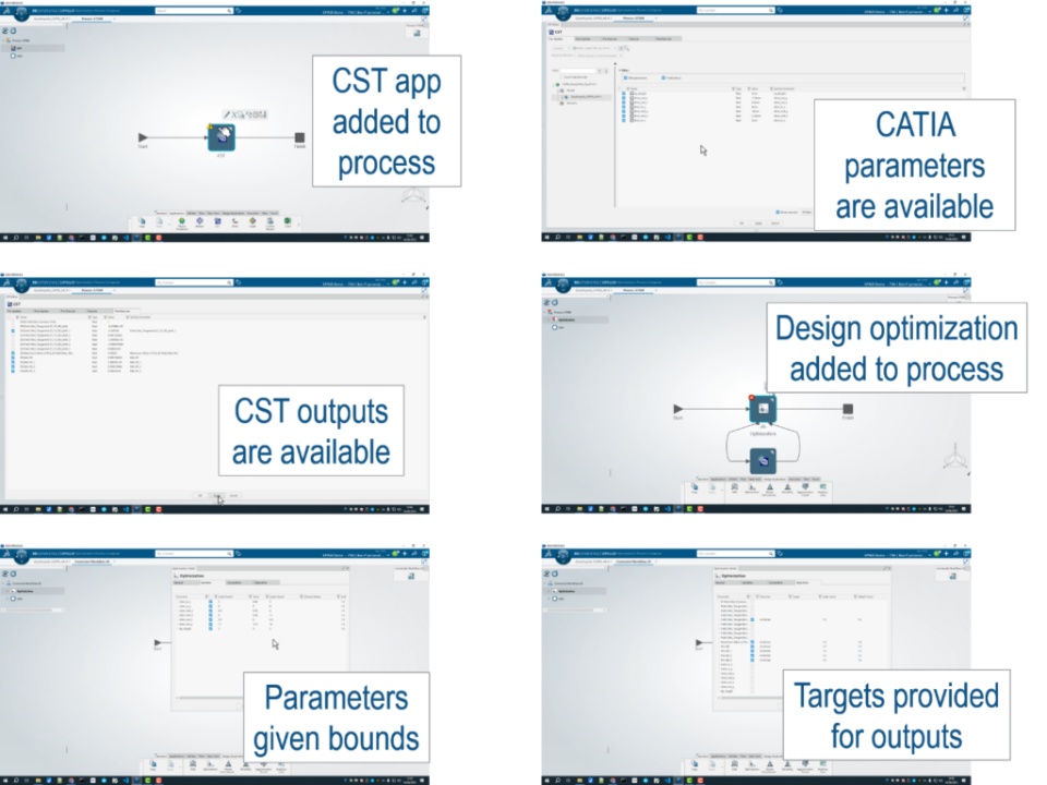

Optimization
Optimization Process Composer was used to build an optimization process using CST Studio Suite driven by the parameterized CATIA geometry. Outputs from the CST Studio Suite model were used to set objectives for the optimization.
Figure 3: Set-up of the optimization in Process Composer

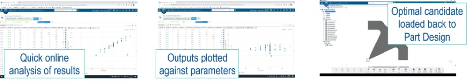

Post-processing
Performance Studio was used to perform initial lightweight post-processing of the optimization results. From the initial results, a candidate geometry was selected.
Figure 4: Selecting the optimal candidate.

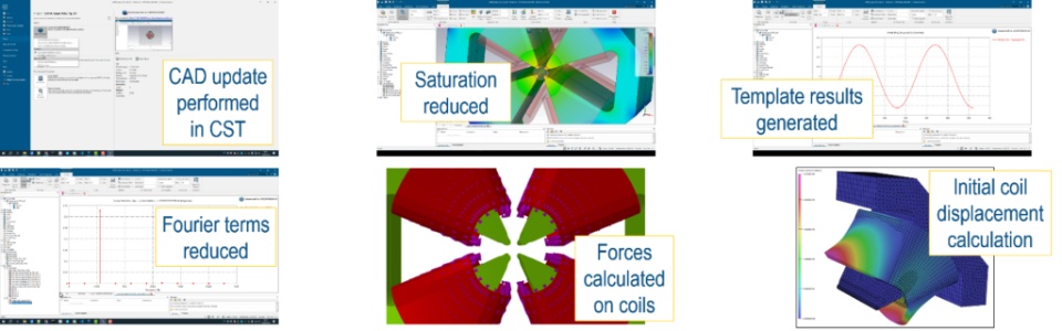

Candidate Geometry
A CAD update of the candidate geometry was automatically performed in CST Studio Suite, and the resulting model re-simulated. It outperformed the initial model on all the relevant criteria.
The force generated on the poles and coils were calculated for subsequent mechanical evaluation. An initial calculation was made of the coil displacements.
Figure 5: Verifying the optimized design and calculating structural performance.
