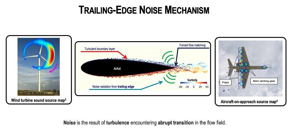

This presentation demonstrates the usage of a Lattice-Boltzmann solver to study the noise mitigation mechanisms in the application of a permeable trailing edge. The study employs a NACA 0018 airfoil installed at zero angle-of-attack. The permeable trailing edge has been modeled in the simulation as an equivalent fluid region where Darcy's law applies. Due to the limitation of Darcy's law in regions with small thicknesses, an alternative multi-layer modeling approach has been proposed and validated. Subsequently, this approach examines the behaviors of turbulent pressure fluctuations nearby and inside the permeable trailing edge.
It is found that the interaction between pressure fluctuations on both sides of the trailing edge weakens the impedance discontinuity at the trailing edge, which is eventually responsible for the noise reduction.
