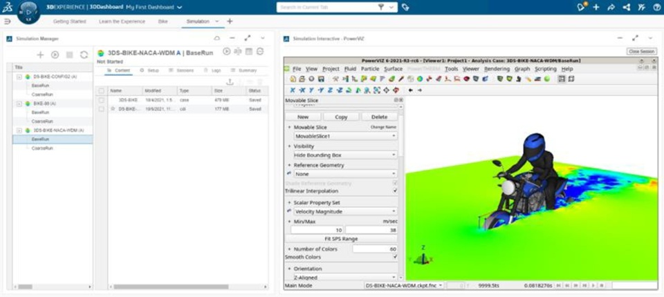

[NEW] PowerFLOW Power'By Simulations (Simulation Manager) :
 - You can now run PowerFLOW Simulations on 3DEXPERIENCE Cloud from the Simulation Manager app and using SIMULIA Unified License Model. A variety of compute configurations are available for Discretization (128, 256, 512, 715GB of memory) and Simulation (216, 504, 1008 CPU cores). PowerINSIGHT batch jobs can be run automatically upon completion of the simulation.
 - PowerFLOW results can then be post processed remotely using in-browser sessions of PowerVIZ and PowerINSIGHT. Experience Content can be generated interactively to be reviewed on 3DDashboards.
In-browser remote session of PowerVIZ
Note some limitations for this first release: Pre-processing (PowerDELTA, PowerCASE) does remain local and requires local installation and client licenses. Also, support for thermal and acoustics workflows will be added in future.

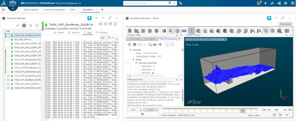

[NEW] XFlow Power'By Simulations (Simulation Manager) :
 - You can now run XFlow Simulations on 3DEXPERIENCE Cloud from the Simulation Manager app and using SIMULIA Unified License Model. A variety of compute configurations are available including CPU (16 to 396 CPU cores) and GPU (16 to 160 GPU streaming-multiprocessors corresponding to ~1/4 to 4 GPUs) configurations.
 - XFlow results can be post processed remotely using in-browser sessions of XFlow
In-browser remote session of XFlow
