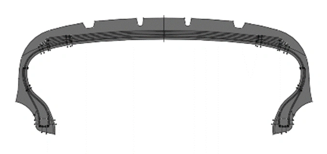

In this example, you are provided a CAD model for the cross-section of a tire. You must define and run a structural simulation to analyze the tire’s footprint on a flat surface (for example, a road), among other types of results. Specifically, you learn how to:
  • Define the tire’s cross-sectional model, including its finite element model.

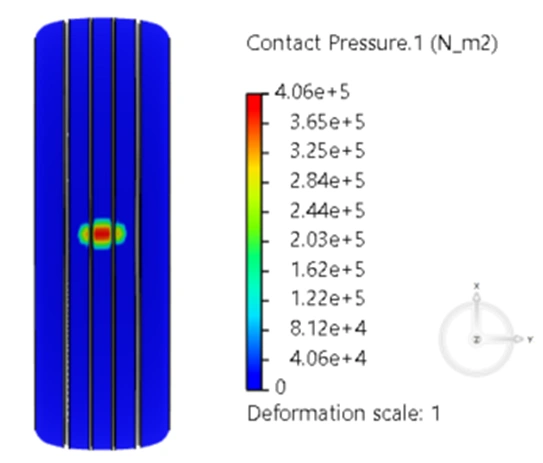

  • Define an analysis case for the full 3D tire model to mimic its contact with a flat surface.
  • Analyze the contact pressure (that is, the footprint), stress, and displacement in this state of contact with the flat surface.
