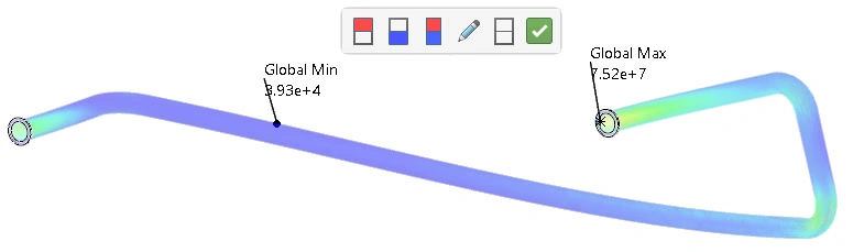

The R2025x FD01 user assistance includes a new 3DEXPERIENCE example that teaches you how to perform a structural analysis based on thermal expansion. In this example, a pipe segment whose end locations are fixed by attachment to other components in the system is subjected to a temperature change and we locate and evaluate the maximum and minimum stress locations.
