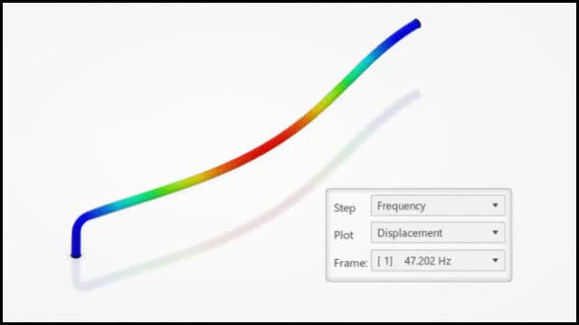

This example guides you through using the 3DEXPERIENCE platform and the Linear Structural Validation app to define and run a frequency simulation that evaluates the natural frequencies and mode shapes of a pipe segment. The pipe segment is attached to a pump, and your objective is to determine whether any of the pipe segment’s natural frequencies are within the operating range of the pump.

  • Apply common simulation features, such as boundary conditions and materials.
  • Define and run a frequency simulation.
  • Analyze natural frequencies and mode shapes.
