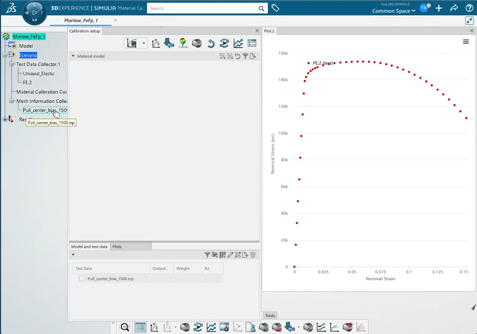

What is unique about the Marlow and Valanis-Landel (VL) models ? Most hyperelasticity models in Abaqus use an equational form, defining those forms by material parameters. The Marlow and VL forms of hyperelasticity use test data to define the model. The Marlow uses one piece of test data and the VL model uses two pieces of test data. These test data must have a Deformation Mode attribute like Uniaxial, or Biaxial, etc.

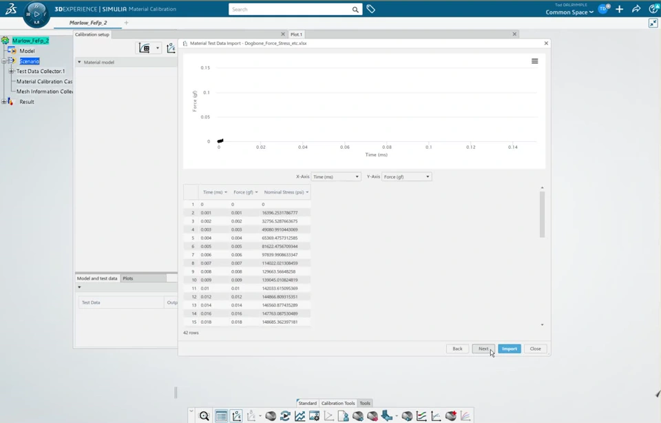

Note : The "quirk" I mentioned above "a quirk of using the Marlow or Valanis-Landel hyperelasticity models in FE mode". When one imports test data while in Analytical or Numerical mode, they are asked to define a Deformation Mode.
In FE mode, we think of the test data used for calibration (experimental data matching to the FE result) to be very general. Data like forces and displacements from a three-point bend test, or indentation tests, for example. Because of this, while importing test data in FE mode, one is not able to declare a Deformation Mode. The Deformation Mode is defined by the FE model(s) itself.
If one wants to use a Marlow or VL model in FE mode, one must first import the data that will define the Marlow or VL model while in Analytical or Numerical mode. We will demonstrate that in the video below.

This first video, named Marlow_FeFp_1c.mp4 shows a successful calibration set-up and Evaluation. The 3dxml file for this calibration object is contained in the attached zip file.
Note: It turns out that in R2024x HotFix 4.20 there is a bug associated with this workflow. It is related to how the software numbers each piece of test data.
The video below was created on on August 14, 2024 using the 3DExperience public cloud, R2024x, HotFix 4.20
I point out the action that leads to failure due to this bug at the 1:30 mark of the video.
