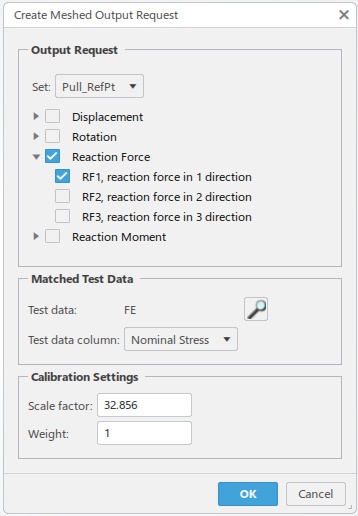

3) Map the FE output of RF1 to be compared to the nominal stress data set.  Set scale factor to 32.85625

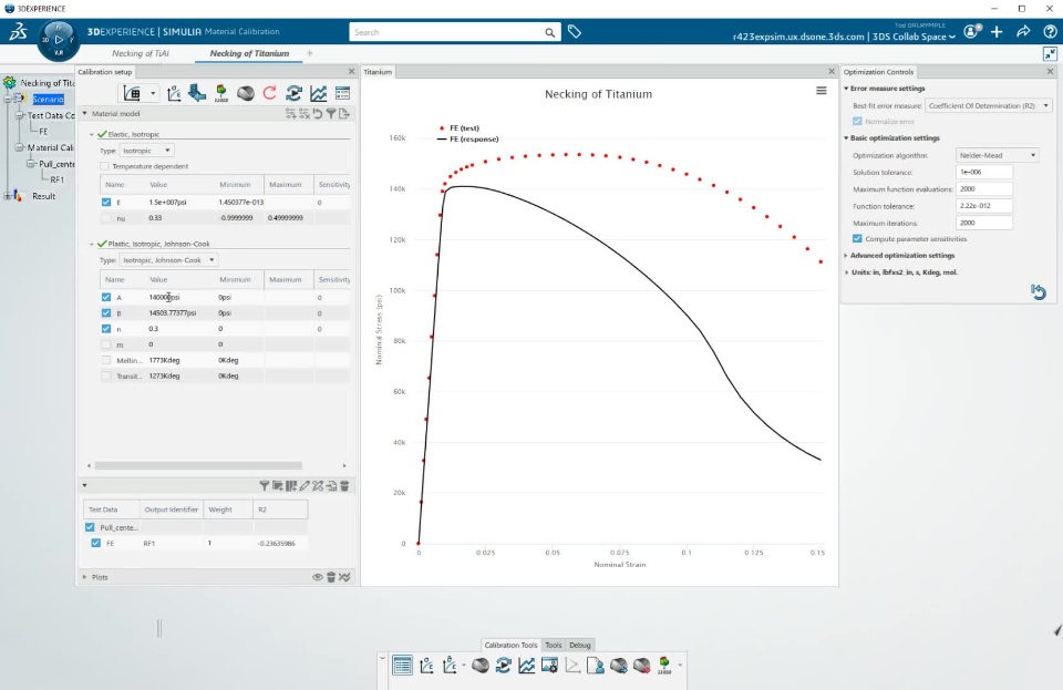

6) Use the "Evaluate" feature to show a one-time comparison using the current model parameters.  Possibly adjust parameters by hand and re-run "Evaluate".

The mapping of the RF1 model output to the test data looks like this:

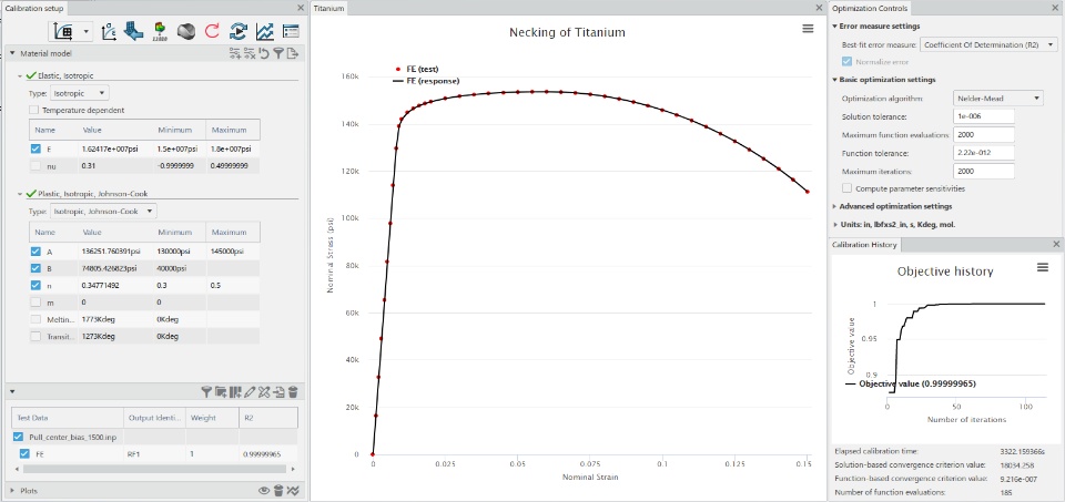

In the video, I commented that the optimization settings (especially those related to stopping the optimizer) were developed for the very fast running analytical mode.  In the future we may develop a separate set of settings for FE mode, but for now we have not.  This means that manually stopping the optimizer might be quite common in FE mode.  The image below shows the final state of the calibration:

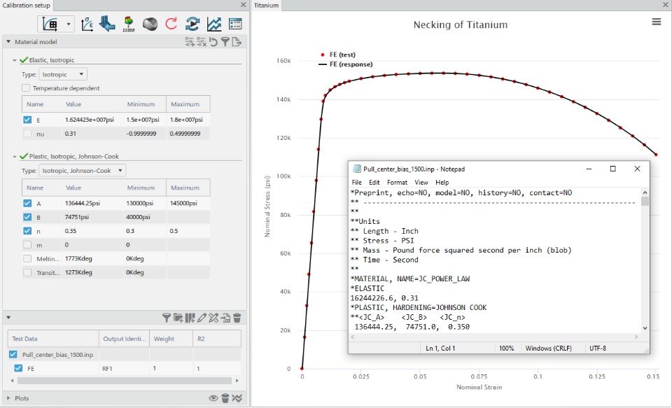

Since we used synthetic test data, we know the right answer. Just to double check things, I then typed in the known right answer.  You see below that the right answer gives a R2 value of a perfect 1 (to 8 decimal places).
