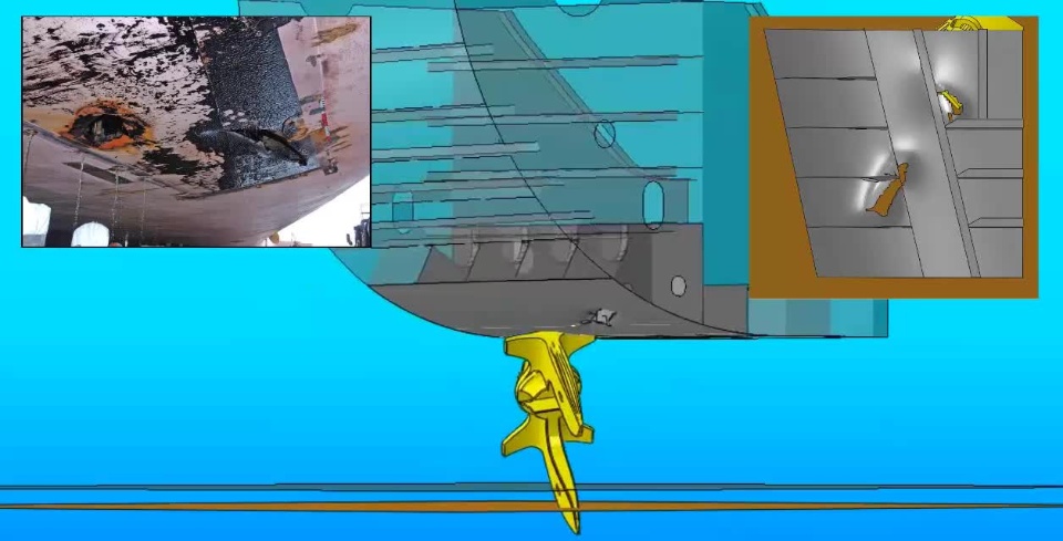

The arguments revolved around the role of the anchor, of which there was no doubt that this was the offending article. It has two possible resting positions; one with the flukes down (the large prongs that dig into the seabed) which would mean that the ship would have to be very low in the water for contact to be made, and one with the flukes up (as shown in the picture) meaning that contact with the hull was much more likely.

I devised a simulation using Abaqus/Explicit which consisted of a mostly rigid section of the hull with a flexible section in the region of the damage. The model used shell elements to model the hull and the bulkheads with material damage initiation and damage evolution to try and replicate what had been reported after hull inspection. The approximate speed of the vessel was known at the time of impact but very little else – particularly the aspect of the anchor with regard to the riverbed and the effective compliance of the riverbed itself.
After numerous attempts experimenting with softened contact, angles of attack and initial position, a simulation was produced that resulted in the included animation. The location and extent of the tear and puncture holes were remarkably close to that witnessed. The ship makes contact with the tip of the fluke which results in a tear in the hull and a rotation of the anchor on the riverbed. This rotation then causes the palm of the anchor to puncture the hull a little way from the tear. The animation shows the general process as well as a view from inside the hull as the damage occurs. I have also included an image of the damage from the outside taken when the ship was in dry dock.
Was the damage to the hull really caused this way? We will never know for sure. But what we do know is that the simulation was based on sound structural mechanics and explicit dynamics as provided by the Abaqus software. In contrast, the ‘other side’ had commissioned an animator, who had worked for the Disney Corporation, and he had produced an animation of how the damage could have been caused by the anchor in its ‘flukes down’ position. Unfortunately, this had more in common with the physics displayed in a ‘Road Runner’ cartoon than in reality. Anyhow, the Abaqus simulation was sufficient to convince the lawyers and the Judge in the case that there was a reasonable possibility that the damage might have been caused by the anchor in the ‘flukes-up’ position, meaning that the shipping company was not to blame. In fact, after very lengthy proceedings, the Judge ruled that the real culprits were the people who left the anchor on the riverbed in the first place, but the identification mark on the anchor was mysteriously missing so they could not be traced. This left the US taxpayer with a clean-up bill of several hundred million dollars, but at least it led a ban on all single-skinned ships from transporting oil.
