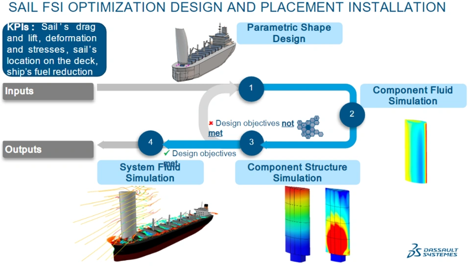

The workflow highlights a sequential fluid-structure interaction (FSI) optimization simulation of the isolated sail geometry through a parametric CAD design. The democratization of this process is extended on the 3DEXPERIENCE platform, enabling the shift towards high-fidelity simulation methodology to an earlier stage.
The initial phase involves the generation of parametric CAD geometry, wherein the outer and inner configurations are precisely defined. This includes specifying details such as the quantity and dimensions of wing ribs and wing spars. The entire hull, including elements like superstructures and cranes, is also established during this stage. Additionally, all material properties involved in the design are explicitly outlined in this phase.

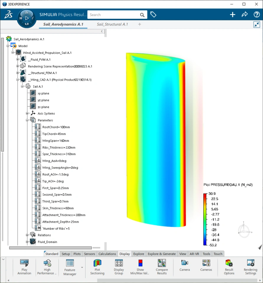

In this process, once the parametric CAD is created, the designer computes a sequential FSI starting with the steady aerodynamic performance of the isolated sail, through a CFD fluid simulation on the  3DEXPERIENCE platform.  This is a single-phase and steady-state N-S simulation, where it is set as the flow velocity and extracted as the main KPI, with the pressure distribution along the sail. This region mapping will be AUTOMATICALLY used as an input for the sequential FSI Structure simulation.

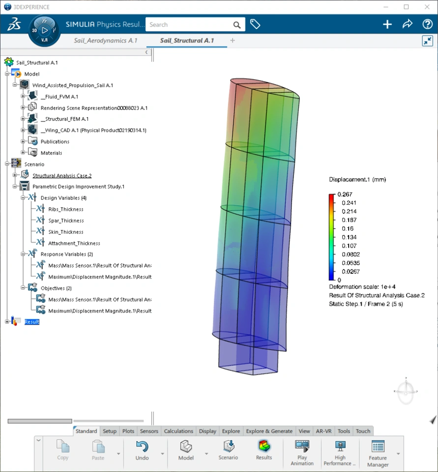

Subsequently, the structural simulation of the isolated sail is performed. All internal connections are defined in this step. This static and implicit structural simulation is also done on the 3DEXPERIENCE platform, getting the main KPIs: the stresses and deformations.
If the design objective is not met, the designer can define alternatives using optimization and approximation models, iterate on the external shape or size of the geometry to improve aerodynamics, or change covering materials or thickness to improve structural integrity.
If the design objectives are met, the first loop finishes.

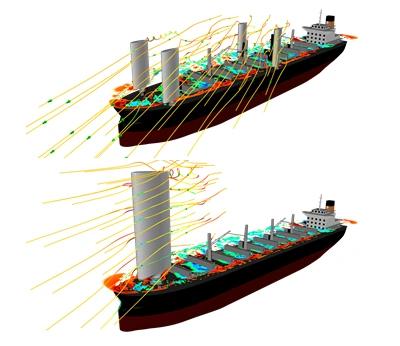

To handle the limited deck space available on a cargo ship, the second loop of this workflow is used to optimize the placement of the sail and its installation. This system simulation provides a high-accuracy unsteady VLES CFD based on LBM, where the cross flow and the impact of the sails over the cargo ship are analyzed depending on the compass rose the engineer set  up. This allows us to define the proper placement on the deck and compare different configurations like this 1 vs 4 sails:
This sequential cosimulation can be optimized using the automated Process Composer on the 3DEXPERIENCE platform, where the designer defines the KPIs to maximize and minimize and the algorithm automatically performs the iterations over the geometry.
