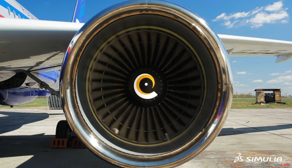

​​​​​​​​​​​​​​In the quest to design more efficient and sustainable aircraft, the turbofan engine provides an elegant solution. Using a fan to draw in extra air, which helps propel the aircraft, these engines provide thrust and boost fuel efficiency. While turbofan are generally quieter than turbojets, the engine is still a main contributor to community noise at takeoff and on landing.
