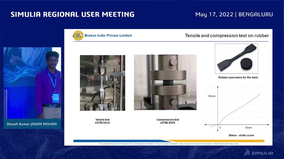

This paper validates a brake chamber under a pressure load of 10 bar. A simplified structural model is initially developed to perform static nonlinear analysis in Abaqus software. The FEA results are compared with physical strain gauge measurements on a proto-model; reasonable correlation is achieved in a few locations, but a considerable gap is observed in correlation levels at other locations. Clamping load due assembly process is considered to improve accuracy with a diaphragm made of fabric reinforced rubber, modeled using hyperelastic material models available in Abaqus. The correlation then improves to 85%. Further, considering thinning/thickening effect of sheet metal parts during forming operation, FE results correlated well with more than 95%. Accuracy is improved now, but with all these complexities added in the 3D model setup, the overall calculation time is increased drastically due to more node counts. To meet the fatigue performance of the structure, further design iterations and optimizations are needed. But with the detailed simulation model, performing multiple iterations is challenging to meet the project timelines. To overcome this difficulty, the model is simulated using the axisymmetric analysis capability in Abaqus by taking advantage of the axis-symmetric design of most of the parts. Now the model is simplified without compromising accuracy by retaining all the complexities and details included earlier in the study. With this new approach, multiple design iterations could be completed with a quick turnaround time, and the design is well optimized. At the end of the study, a simplified and more accurate simulation methodology is developed to validate and optimize the design for all future variants in this product range with the least computation time and good accuracy.
