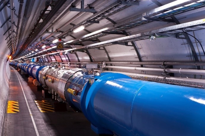

Beams from particle accelerators are used to treat cancer patients and to create radioactive isotopes for medical diagnostics, medicine and sterilization of instruments. They are used to make computer chips and to deal with biological waste. Particle accelerators are also used to study proteins and molecules, including viruses such as COVID-19. The most powerful particle accelerators – such as the LHC at CERN (see Figure 1) – are used for particle physics, built by multi-national collaborations seeking to shed light on the basic constituents of the universe.
Figure 1: Superconducting dipole magnets in the LHC tunnel. Maximilien Brice – CC BY-SA 4.0.

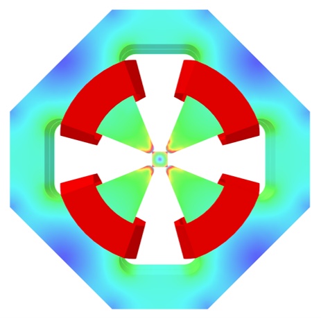

The magnets used to control the beam must be designed accurately if the beams are going to remain focused and reach the target at the desired point. SIMULIA Opera is used to support the design of different types of magnets, with each performing a specific role in these ground-breaking devices. Figure 2 shows a quadrupole magnet modelled with SIMULIA Opera, with the magnetic flux density displayed on the steel poles, and also on a cross-section where the beam would pass.
Figure 2: A quadrupole magnet simulated using SIMULIA Opera.

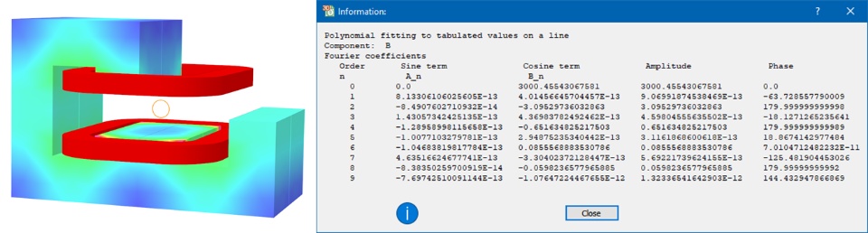

While particle accelerators can take different forms, in each there will commonly be bending magnets, focusing magnets, correctors, and kickers. Typical design considerations include desired outcomes, such as flux density and homogeneity, while observing constraints such as induced forces, heat fluxes and remaining in the desired operating parameters of available materials. Figure 3 shows a ¾ display of a dipole model, as well as the calculation of Fourier coefficients of the flux density on a circle around the beam region – the usual method to show field homogeneity.
Figure 3: Opera dipole model (3/4 shown) including the calculation of Fourier coefficients on a circle around the beam path.

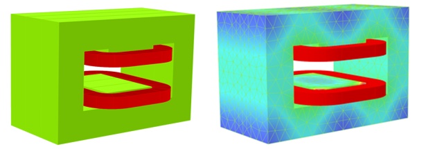

Bending magnets, as their name suggests, use the forces exerted on the particle due its movement in a magnetic field to steer the beam. Force is calculated from the Lorentz force law:
A 3D dipole model is shown in Figure 4.
Figure 4: 3D dipole model in SIMULIA Opera, with flux density displayed on steel yoke on the right.

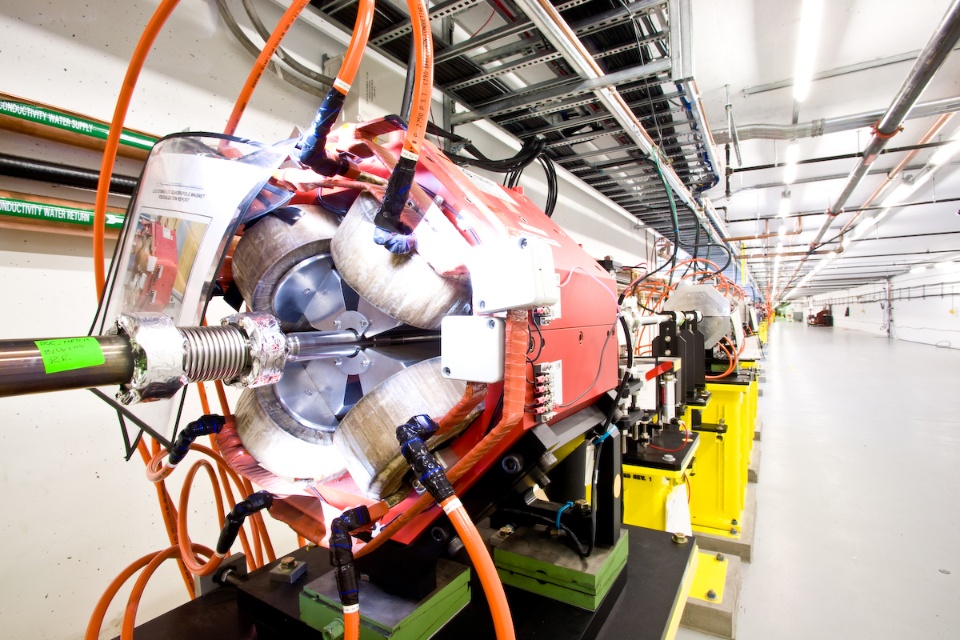

Focusing magnets use field gradients to focus the beam into its desired shape and size. The shape of the poles creates linear field gradients in the beam region:
Figure 5 shows a quadrupole magnet from the SLAC National Accelerator Laboratory.
Figure 5: LCLS quadrupole magnet. https://commons.wikimedia.org/wiki/File:LCLS_quadrupole.jpg. SLAC National Accelerator Laboratory [Public domain].

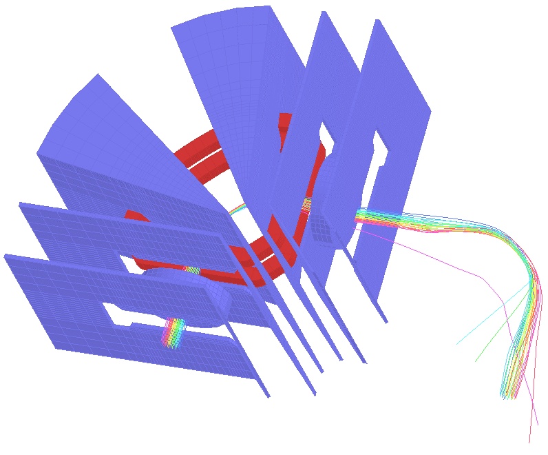

Charged particle beams can be simulated in Opera, and tracked through the complex fields generated by these magnets. Figure 6 shows charged particles being tracked through a specialized dipole called a fragment separator, used to identify short lived radioactive isotopes.
Figure 6: Charged particles being tracked through a specialized dipole with SIMULIA Opera.

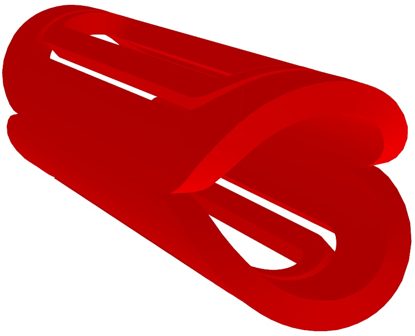

Due to the ever-higher magnetic fields required to advance this science, superconducting magnets are often used, which exploit the behaviour of superconductors, at very low temperatures (around 4 K), to conduct extremely high electrical currents with zero resistance. Superconducting dipole coils modelled in SIMULIA Opera are shown in Figure 7.
Figure 7: Model of a superconducting dipole magnet, modelled with SIMULIA Opera.
