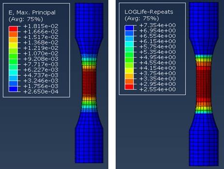

ABAQUS SIMULATION OF SPECIMEN LOADING CYCLE
•Nonlinear kinematic hardening model based on cyclic stress-strain data.
•Initial transient behavior not important since the material comes to a stabilized cyclic response easily.
•Finer mesh around the central region to better capture stress distribution using C3D20R elements.
ISIGHT OPTIMIZATION OF SPECIMEN ELONGATION
•Elongation of the specimen during Abaqus simulation of the loading cycle was optimized using Isight to match the strains recorded in 6 experiments (0.99, 1.28, 1.5, 1.77, 2.1 and 2.4 %).
•This later allows for the direct comparison of fe-safe fatigue analysis results with experimental data.
FE-SAFE LOW-CYCLE FATIGUE ANALYSIS
•Stress-strain datasets for the loading cycles are imported from the 6 elastic-plastic Abaqus models into fe-safe.
•316 Stainless Steel in fe-safe Material Database used for fatigue properties.
•Surface finish of Kt=1 (mirror polished) used to match the test specimen used for the experiment.
•Brown-Miller Algorithm with Morrow mean stress correction used.
